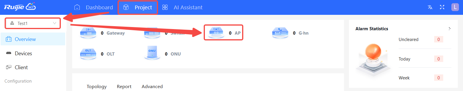

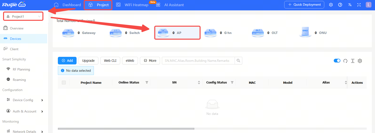

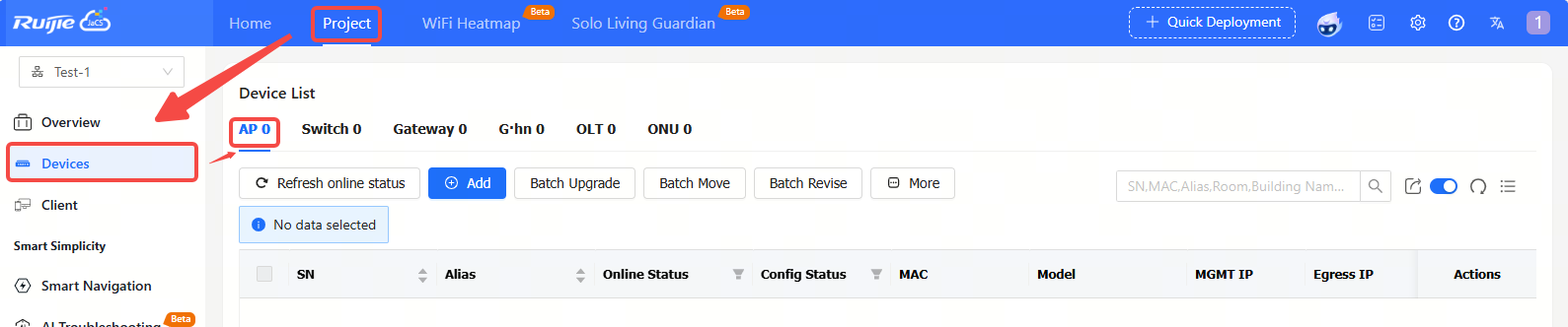

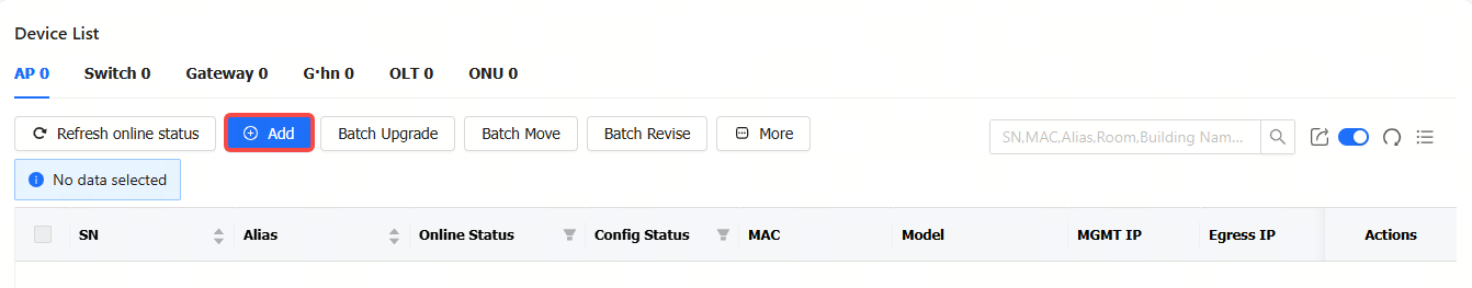

Step 1: Enter the Project interface, select the project where the AP is going to be added, and then click AP to go to the AP management interface.

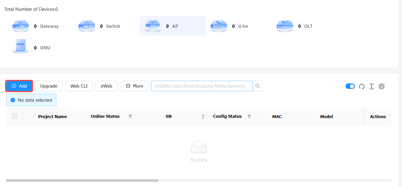

Step 2: Click Add to go to the adding interface.

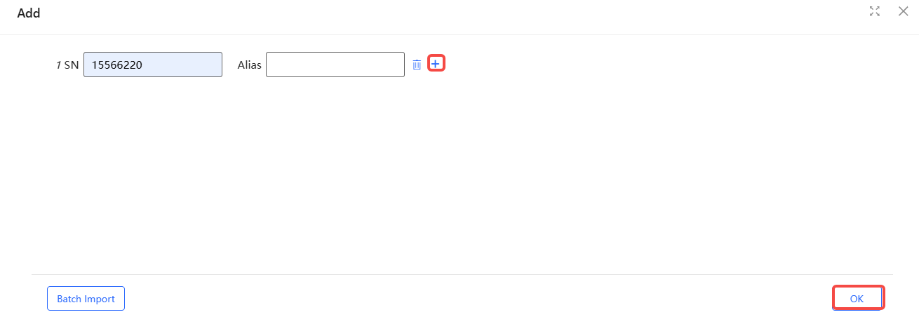

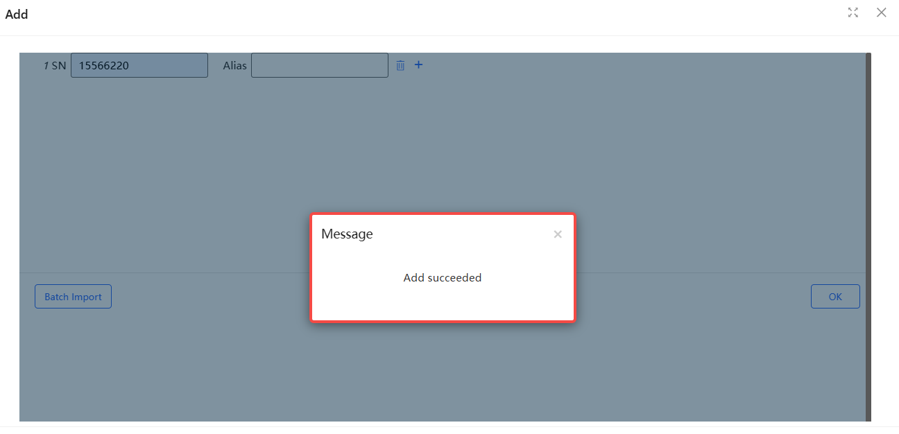

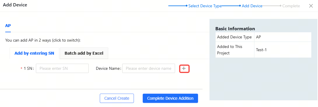

Step 3: Enter the device's SN (required) and alias (optional). If you need to add multiple APs, click + to add them.

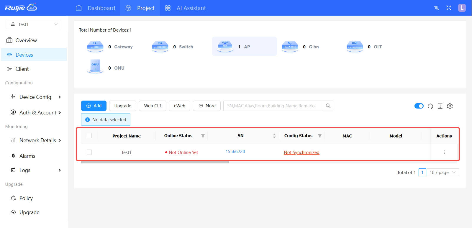

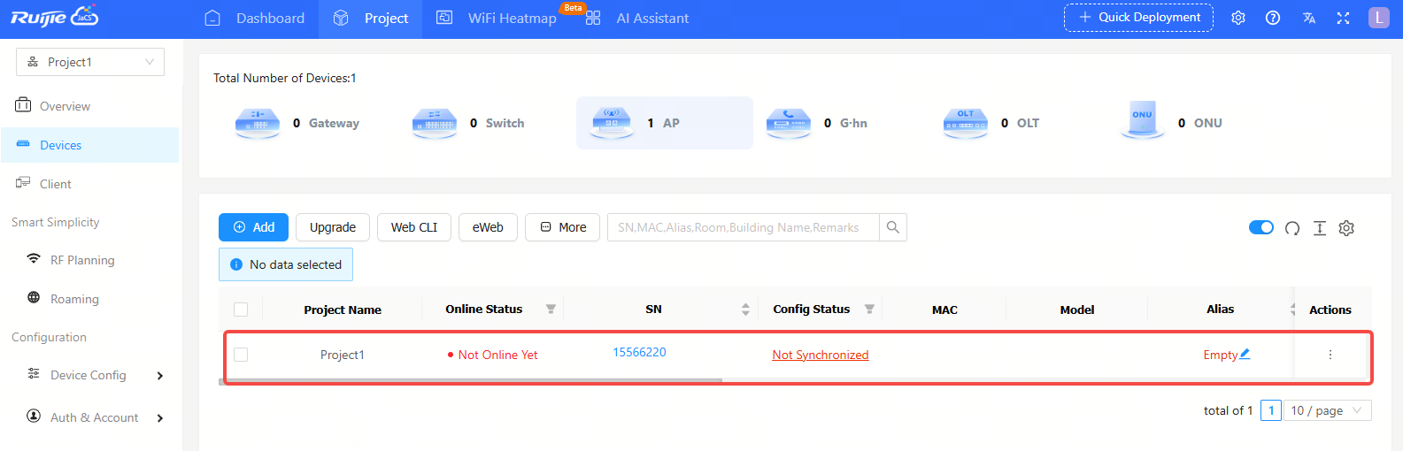

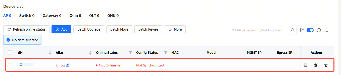

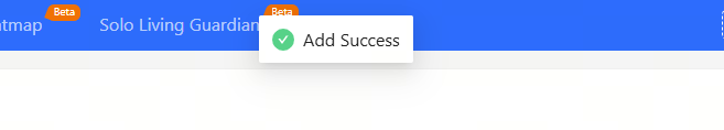

Step 4: After the "Add Succeeded" appears, the operation is completed. The added device will be displayed in the AP list.
