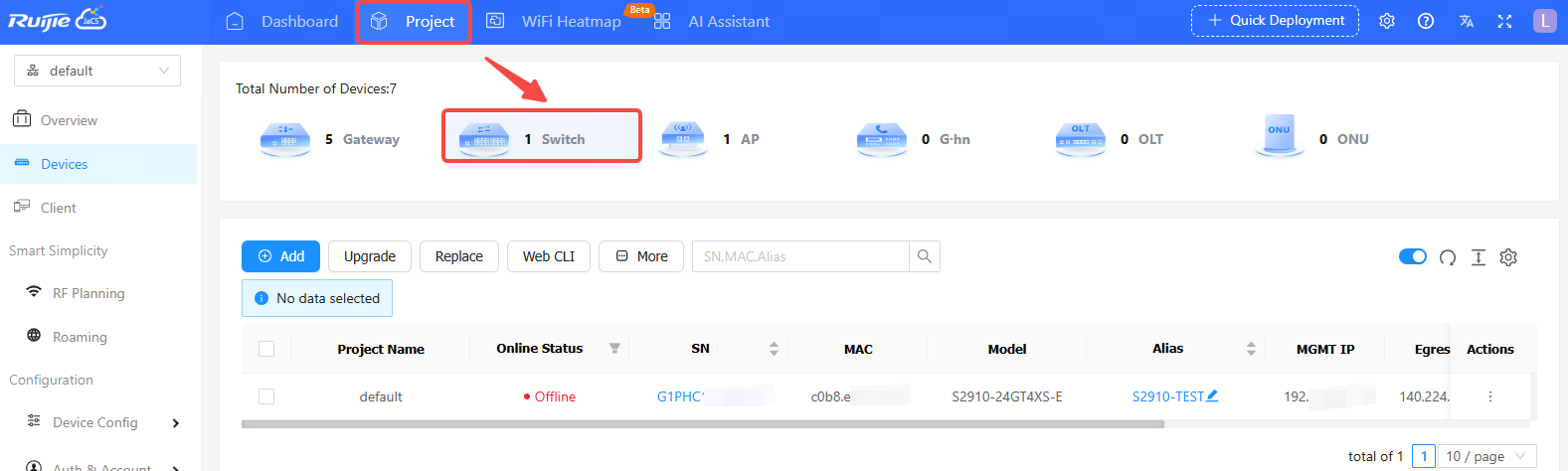

Click Project > Switch to go to the switch management interface. The switch device list will display the information of all switches in the current project by default.
Item Description:
(1) Project Name: Displays the name of the project where the device is located.
(2) Online Status: Displays the online status of the device. The status of the device includes: Online/Offline/Not Online Yet. Click the filter icon  to filter devices by online status.
(3) SN: Displays the SN of the device. Click the SN number of a device to view its details.
(4) Configuration Status: Displays the configuration status of the device. Click the filter icon to filter the devices by configuration status.
(5) MAC: Displays MAC information of the device.
(6) Model: Displays device models.
(7) Alias: Displays aliases of devices.
(8) MGMT IP: Displays the management addresses of devices.
(9) Egress IP: Displays egress IP addresses of devices.
(10) Firmware Version: Displays firmware versions of the devices.
(11) Last See On: Displays last online time of devices.
(12) Action: Delete button is available in the Action column. Click the delete button to remove the device from the project.
Button Description
   : Add button. Click this button to enter the device adding interface.
 : Upgrade button.
  : Configuration replacement button. You can synchronize the configuration of an old device to a new one of the same model. After configuration replacement task is created, the configuration of the old device will be sent to the new one when it is online.
  : Click this button to display more operation buttons, including: Move, Delete, and Restart.
  : Automatic refresh button. The automatic refresh button is enabled by default. When it is enabled, the switch device list will automatically refresh once every minute.
  : Manual refresh button. Click this button to manually refresh the switch list.
  : Row height adjustment button. Click this button to manually refresh the switch list.
  : Click this button to customize the displayed items in the switch list.
 : Search box. Supports searching switches by SN, MAC, or alias.

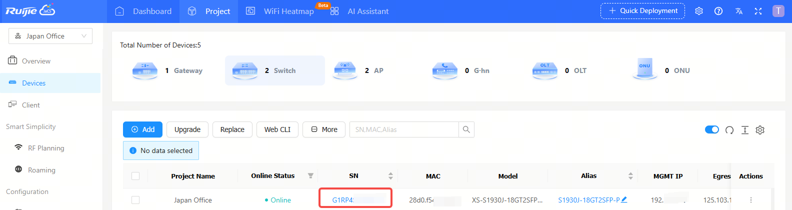

Click the SN of a switch in the switch list to check its detailed information. The detailed interface consists of port panel, basic information, device overview, device port, configuration, PoE, diagnosis and downstream devices.

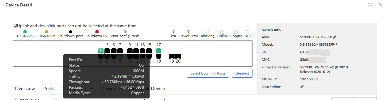

(1) Port Panel
The port panel displays the port type, status and speed. When you hover the cursor over a port, you can view its port ID, traffic, rate, type and other information of the port.

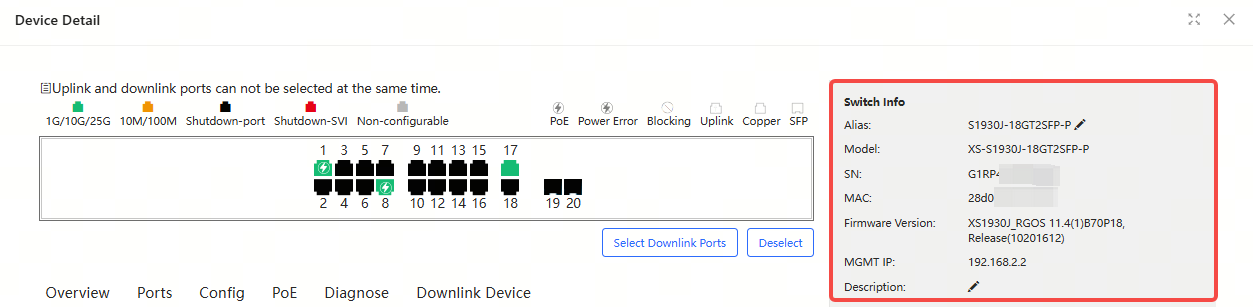

(2) Switch Information
The switch information table displays alias, model, SN, MAC address, firmware version, management IP and description. You can click the edit icon to modify the alias and description of the switch.

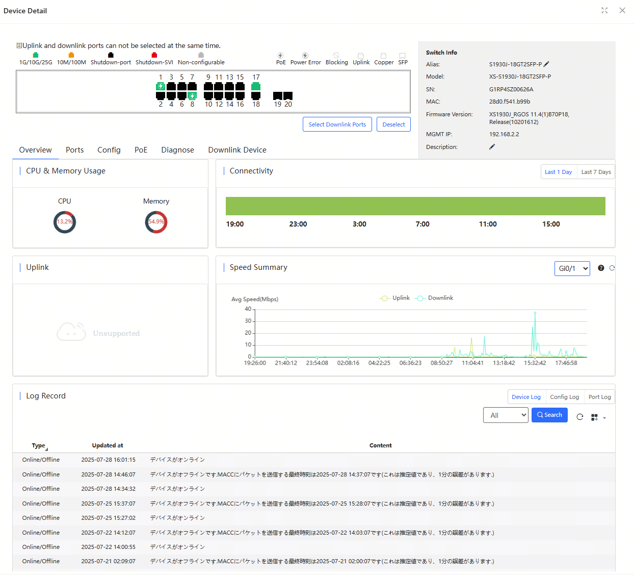

(3) Overview Tab
  • CPU & Memory Usage
Displays the CPU and memory usages of the switch.
  • Connection
Displays the connection status between the switch and the Cloud in the last 1 day or 7 days.
  • Uplink
Display uplink information, including port, speed, duplex, uplink/downlink speed, and uplink/downlink traffic.
  • Speed Summary
Displays the device's uplink and downlink rates in the last 24 hours. Hover the cursor over a time in the chart to view the device's uplink and downlink rates at that time.
  • Log Record
Support viewing three types of device logs, including device logs, configuration logs, and port logs. Logs can be filtered based on log types and time.

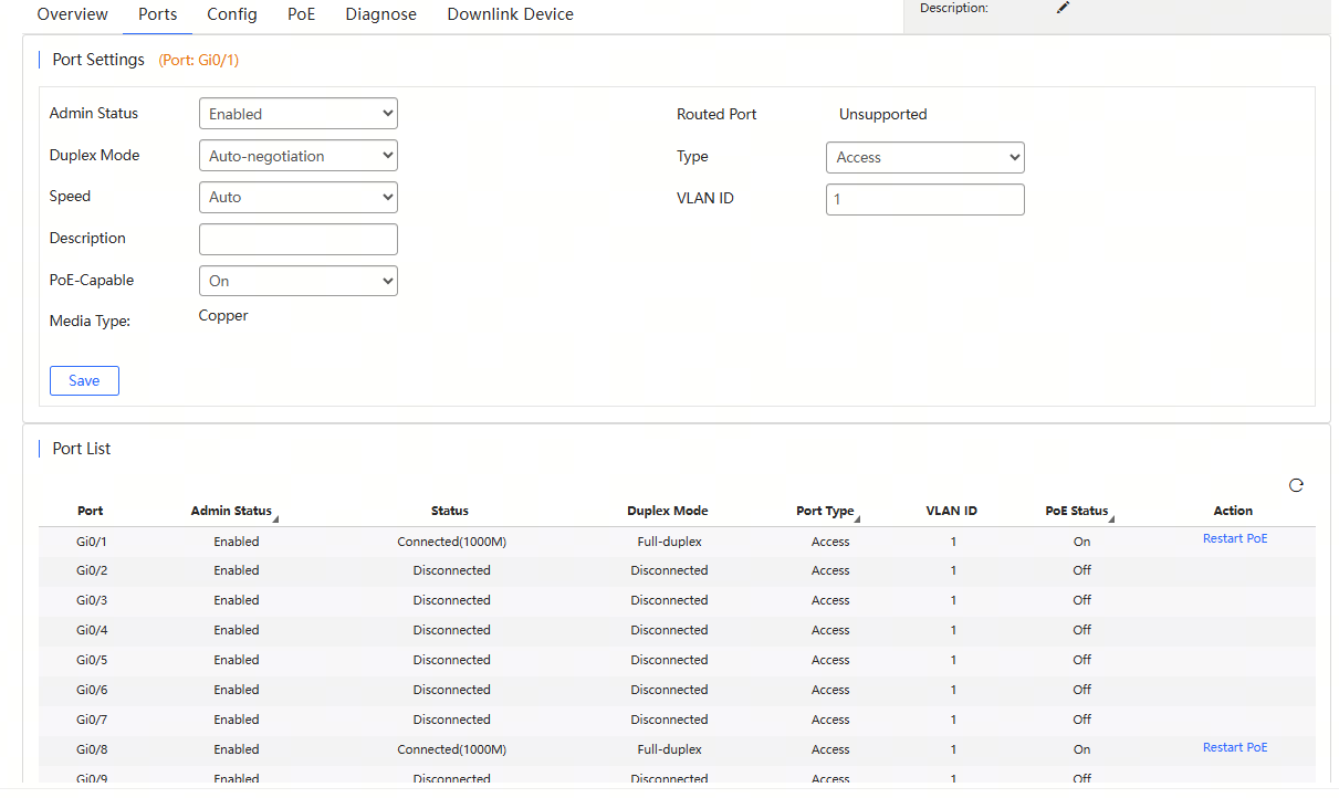

(4) Ports Tab
  • Port Settings
Support setting the port's admin status, duplex mode, speed, description, PoE, port type, and VLAN ID. After completing the settings, click Save.
  • Port List
The port list displays the information of all ports of the device, including port ID, management status, port status, duplex mode, port type, VLAN ID and PoE status. Click the  icon of the Admin Status, Port Type and PoE Status to filter the port information.

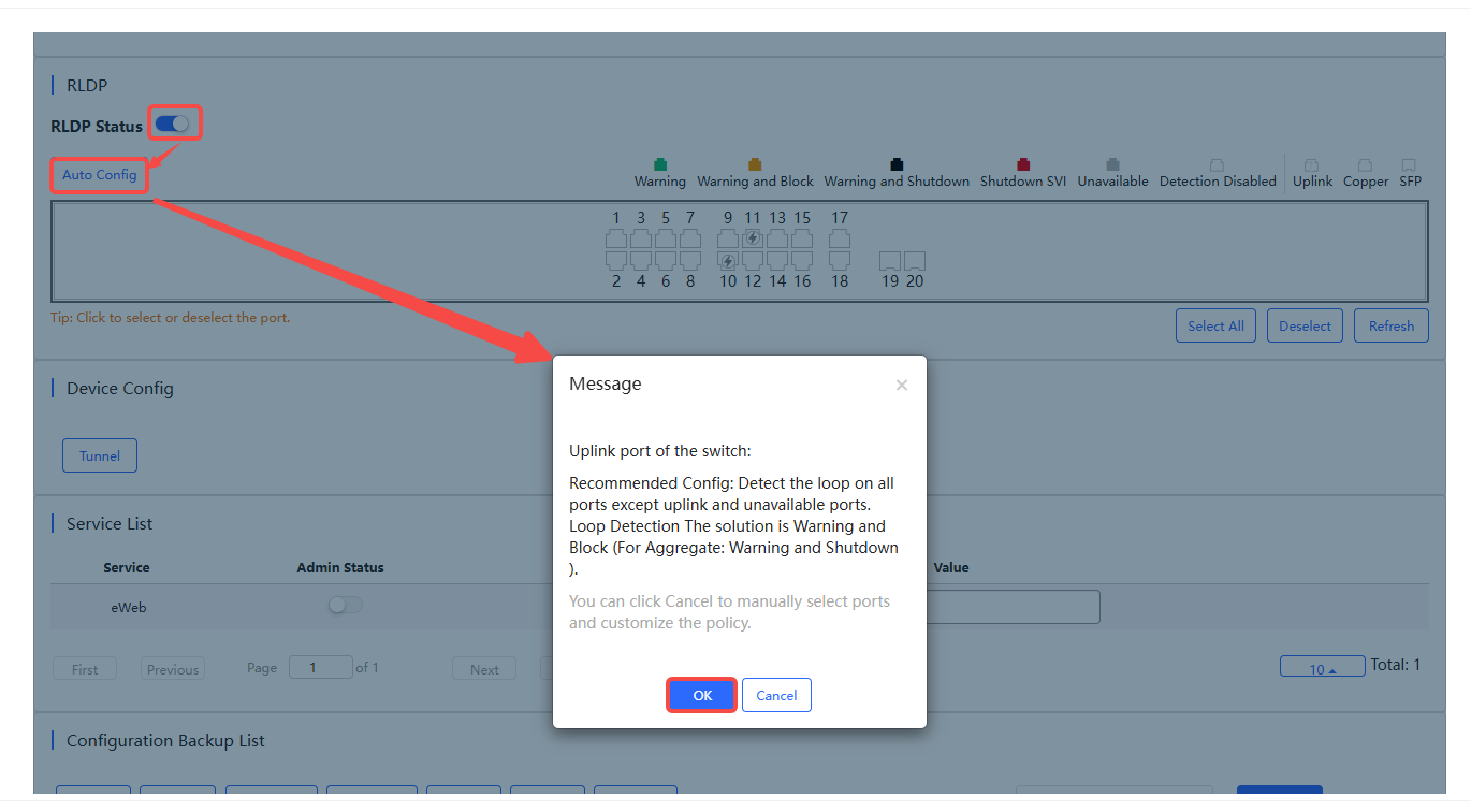

  • RLDP Status
Rapid Link Detection Protocol (RLDP) is a link protocol used to quickly detect Ethernet link faults. After it is enabled, if a fault is detected, it will handle the fault according to the rule set on the device, including generating alarm, port shutdown, disabling the SVI where the port is located, etc. The RLDP is disabled by default. It supports automatic configuration and custom configuration.
Automatic Configuration:
① Enable RLDP status.
② Click Auto Config to use the system default configuration, that is, to perform loop detection on all ports except uplink ports and unavailable ports, and set the loop fault handling mode to Block and Alarm. For loops on aggregate ports, the fault handling mode is Alarm and Close.
③ Click OK in the confirmation box to complete the operation.
