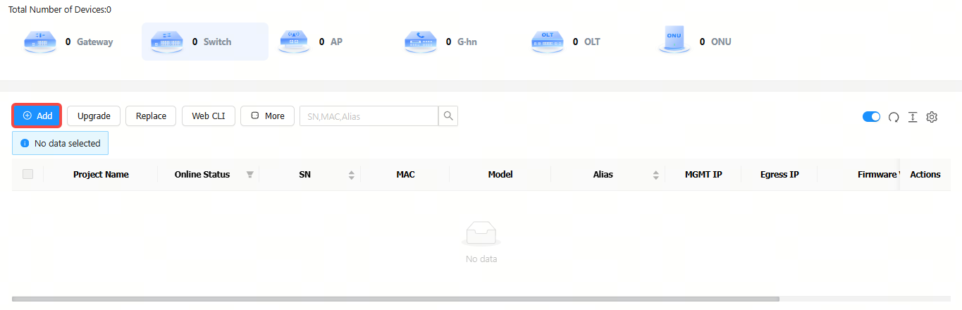

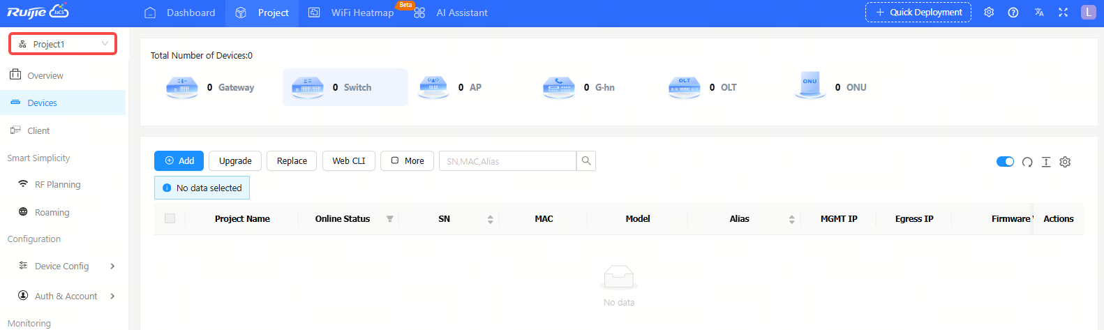

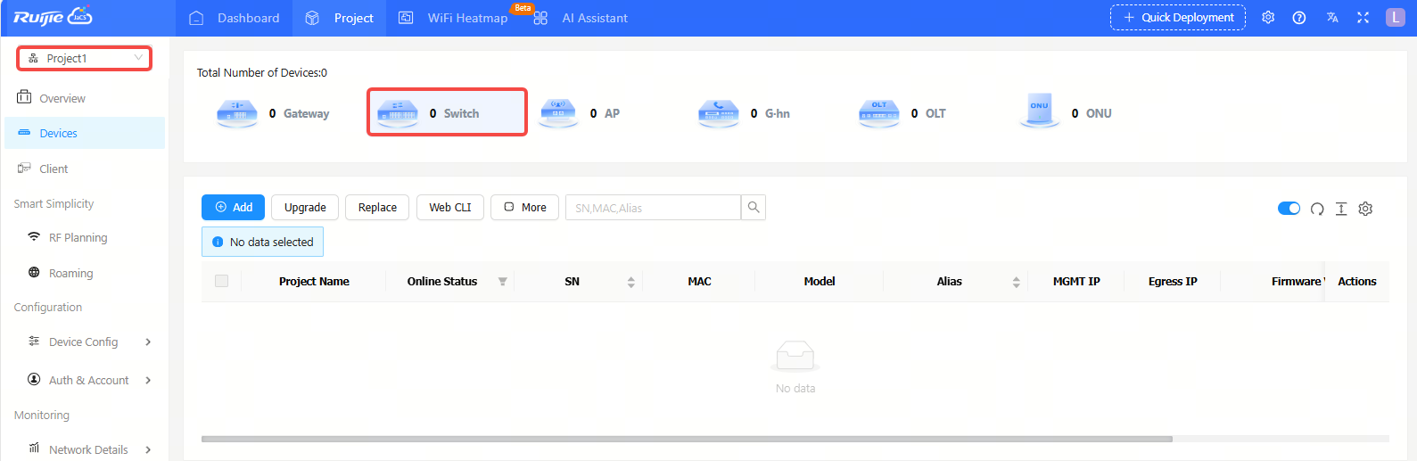

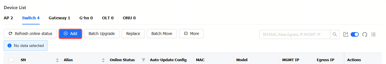

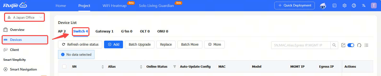

Step 1: Select a project, and click Switch to go to the switch management page.

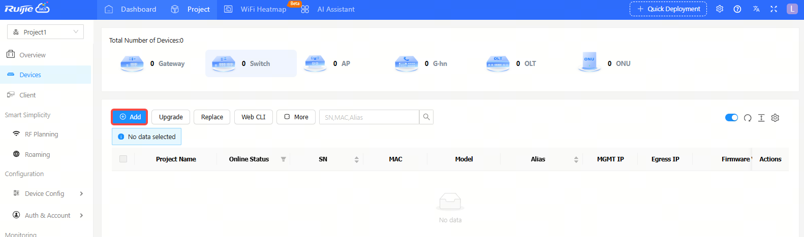

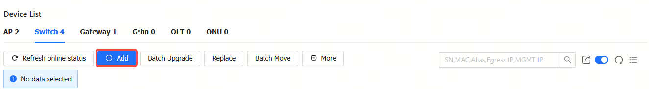

Step 2: Click Add.

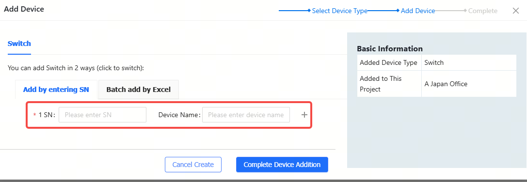

Step 3: Enter the device's SN (required) and alias (optional). The length of the SN ranges from 6 to 20 characters, and the length of an alias cannot exceed 64 characters. To add more SNs, click delete icon; click +; to delete a SN, click . After filling in the information, click OK.

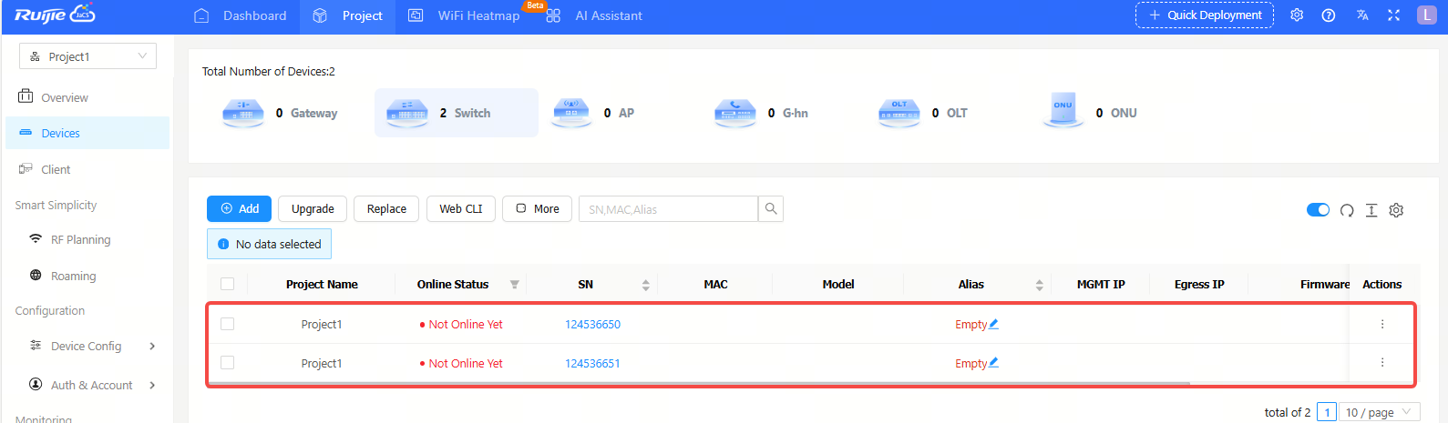

Step 4:  When the "Add succeeded" prompt appears, click X to close the prompt box and complete the operation. The added device will be displayed in the switch list.

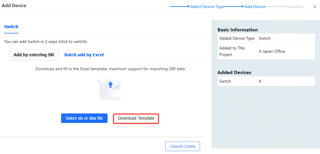

Step 1:  Click Add.
Step 2: Click Download Template to download the template.

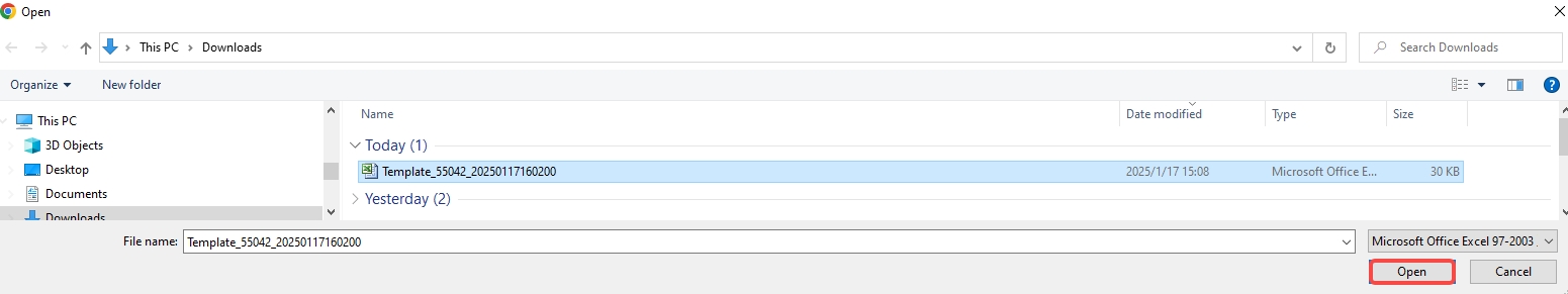

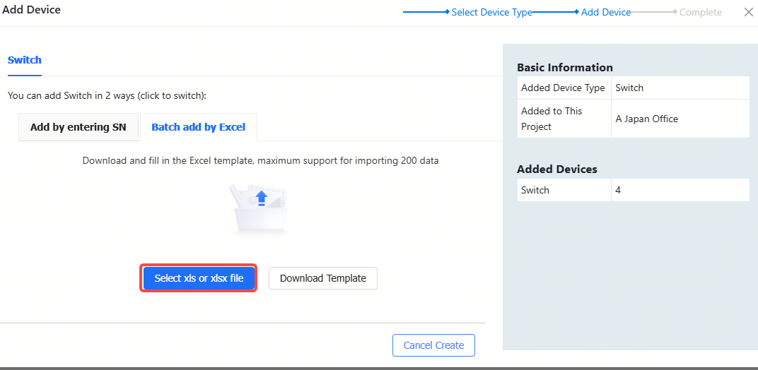

Step 4: Fill in the template. The SN is required, while the alias is optional. Up to 200 devices can be imported at a time.
Step 5: Click ".xls" File to upload the template.
Step 6: When the "Import Succeeded" prompt appears, click X to close the prompt box and complete the operation. The imported device will be displayed in the switch list.
