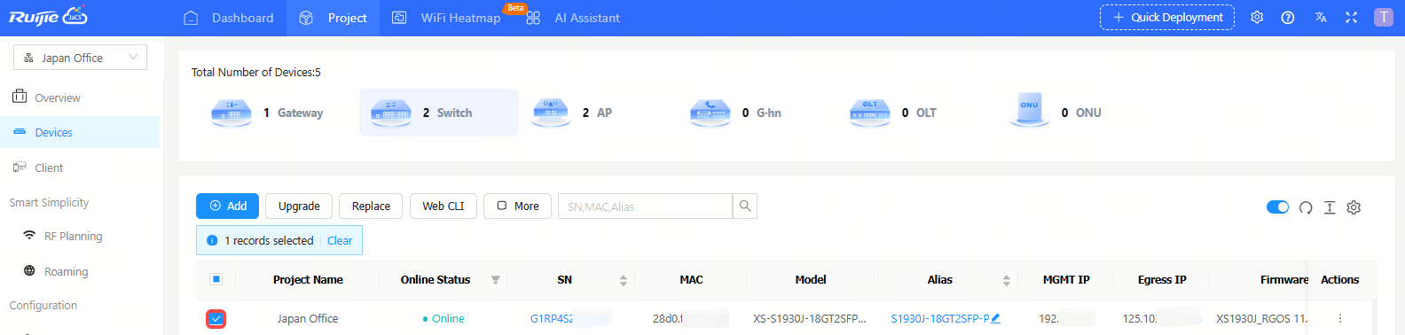

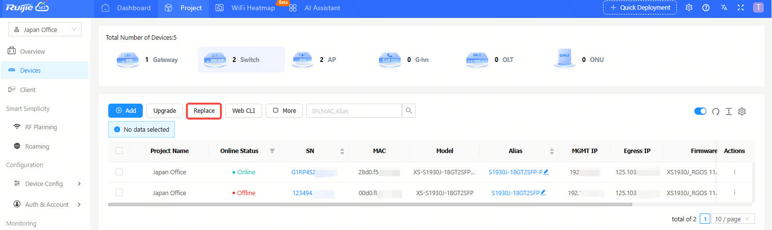

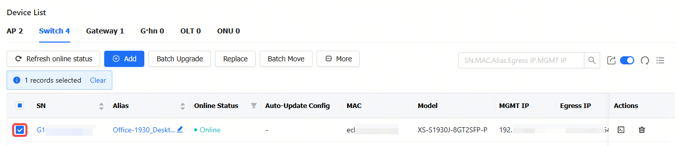

Step 1: Select an existing device and click Replace.

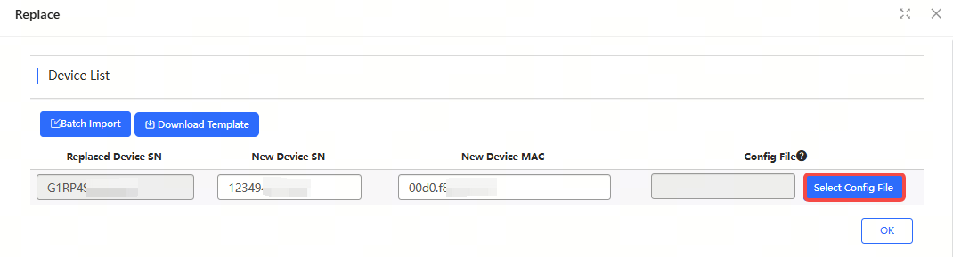

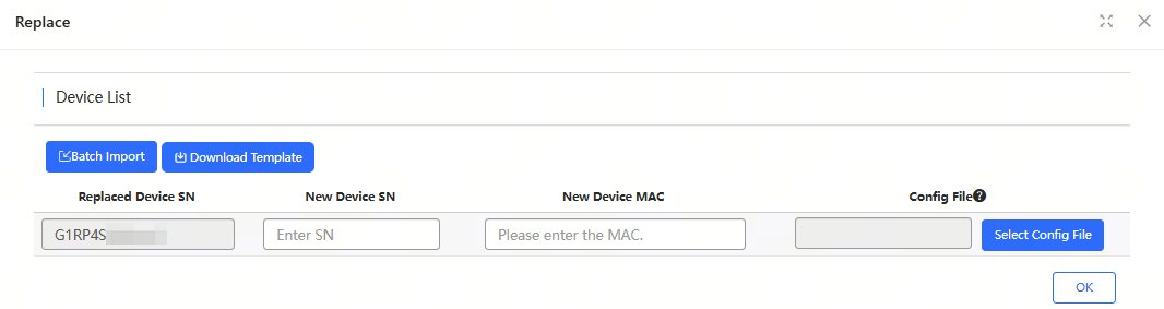

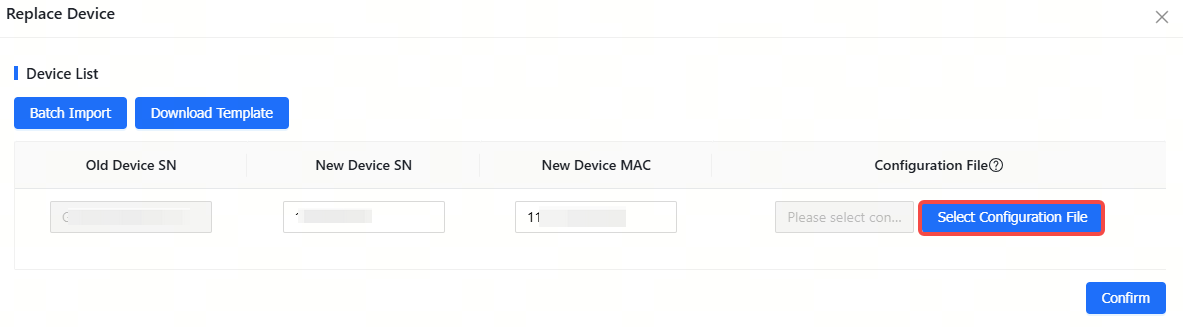

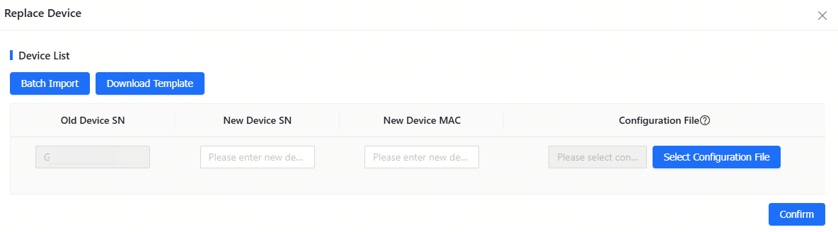

Step 2: Enter the SN and MAC address of the new device. Please make sure that the SN and MAC of the new device match each other.

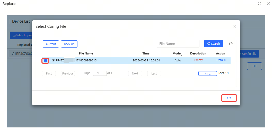

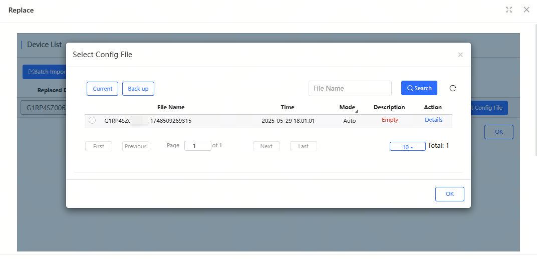

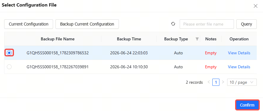

Step 3: Click Select Config File and select the configuration file of the existing device, and then click OK.

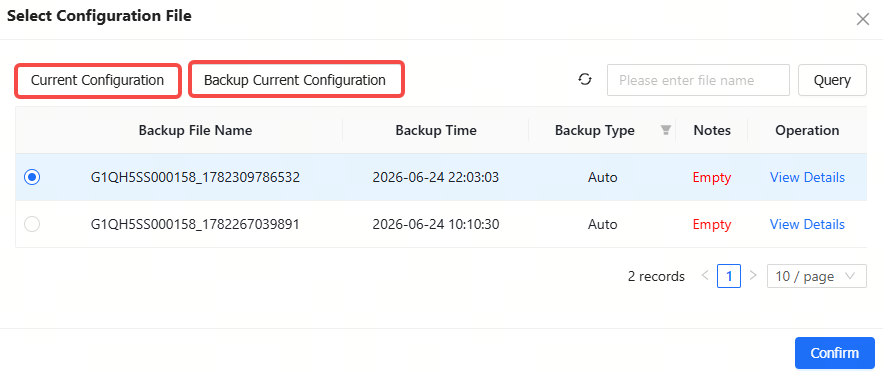

  Click Current Configuration, you can view the current device configuration; click Backup Current Configuration, you can to back up the current device configuration.

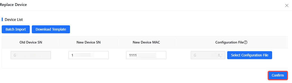

Step 4: After selecting the configuration file, click OK.
Step 6: After the "Submit Succeeded" prompt appears, click X to close the box and complete the operation.

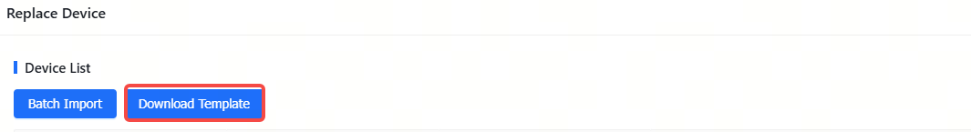

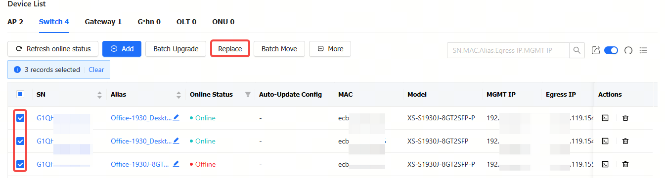

If you need to replace configuration in batches, you can follow the steps below:
Step 1: Select the devices, and click Replace.

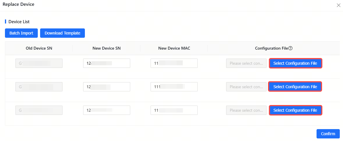

Step 2: Click Download Template to download the template.
Step 3: Fill in the template. You can fill in up to 200 items at a time.
  • Replaced Device SN: Enter the SN of the existing device.
  • New Device SN: Enter the SN of the new device.
  • MAC: Enter the MAC address of the new device.

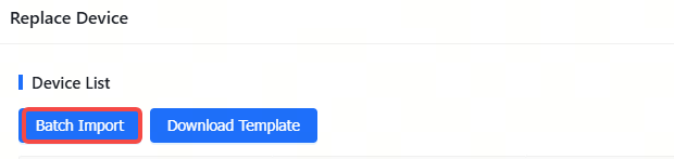

Step 4: Click Batch Import to import the filled template.
Step 5: Select the configuration file for your new switches and click OK.
Step 6: After the "Submit Succeeded" prompt appears, click X to complete the operation.
