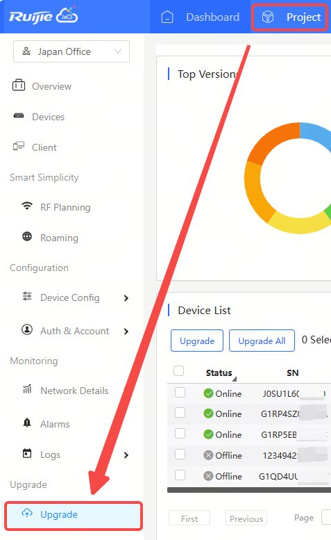

To upgrade devices in batches:
Step 1: Navigate to Project > Upgrade to go to the Upgrade page.

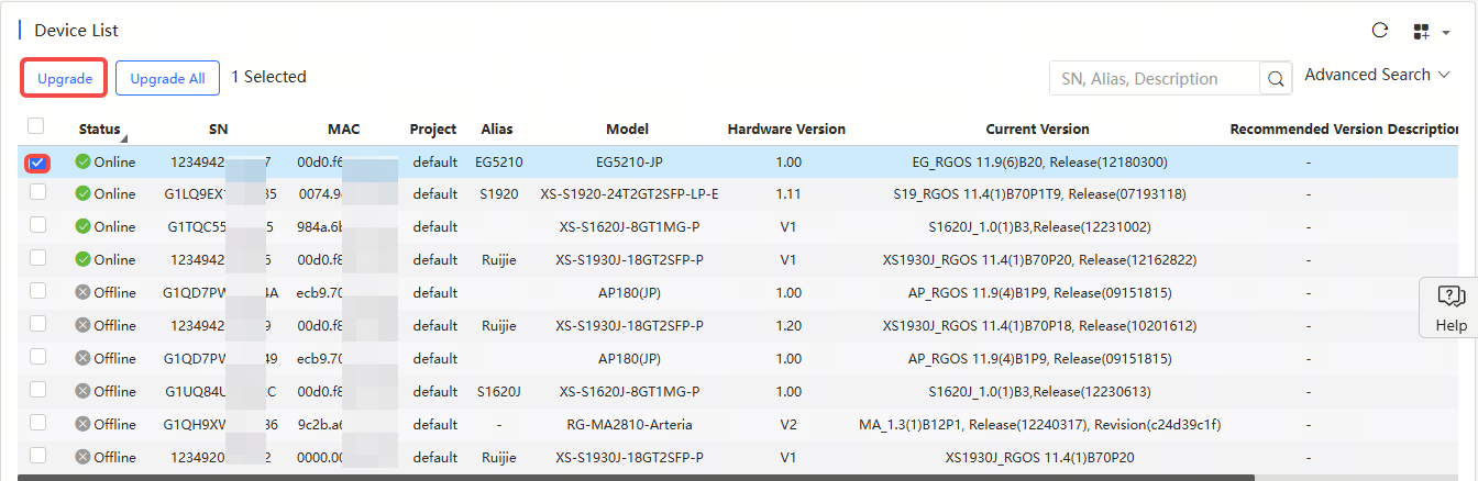

Step 2: Select the device to be upgraded, and then click Upgrade.

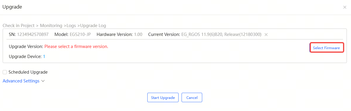

Step 3: Select the firmware version, and set a scheduled upgrade time if it is needed and then click Start Upgrade.
Item Description:
(1) Upgrade Version: If the system has a recommended firmware version, it will be selected by default and displayed here. If there is no recommended version, you need to click  Select Firmware and select the version you need.
(2) Firmware Details: Click Firmware Details to display the information of the selected firmware version.
(3) Scheduled Upgrade: Scheduled upgrade function. This function is disabled by default. After enabling it, you need to set the time period, so that the system will upgrade devices one by one from the start time. The upgrade interval for each device is equal to the set time period divided by the number of devices.
(4) Max Retry Times: After clicking Advanced Settings, you can set the number of upgrade retries. The default number of retries is 5.

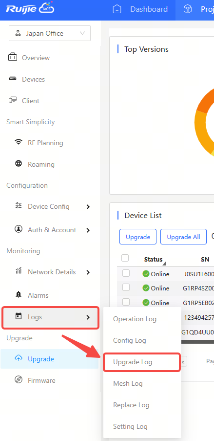

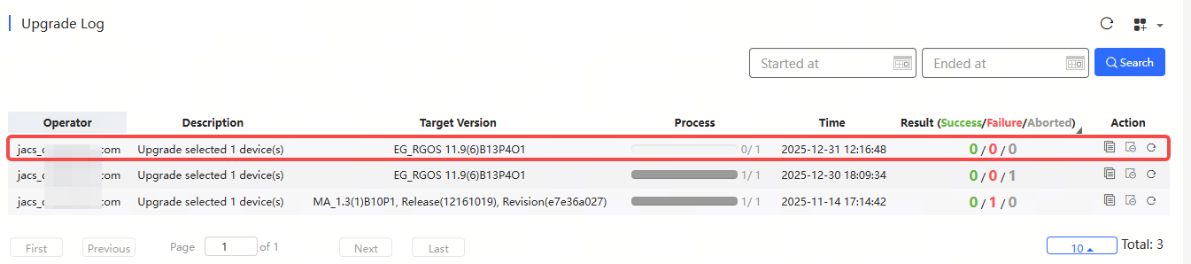

After the upgrade task is created, you can click Logs > Upgrade Log to go to the upgrade log interface. The created upgrade task will be displayed in the log list. Click the three buttons in the Action column to view, cancel, and retry the upgrade task.
Buttons:
 : Click this icon to view the details of an upgrade task.
 : Click this icon to cancel an upgrade task.
 : Click this icon to try an upgrade again.
