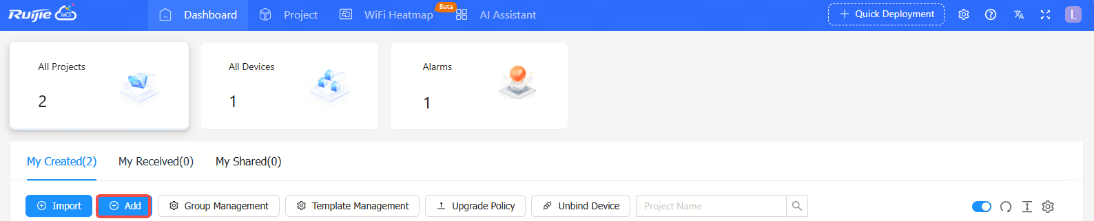

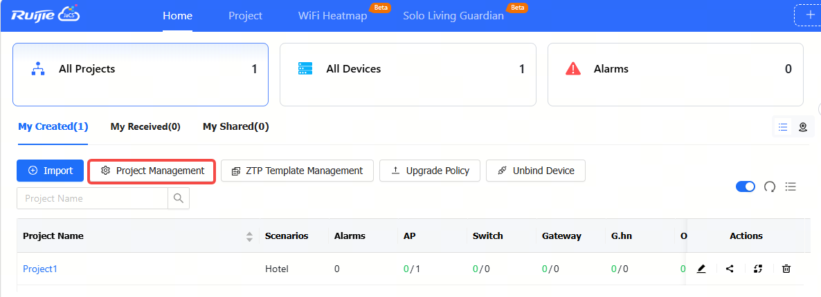

Step 1:  Click Home > All Projects > My created to enter the project management interface, and then click Project Management.

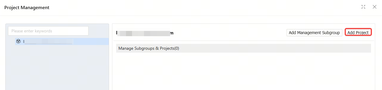

Step 2: Click Add project.

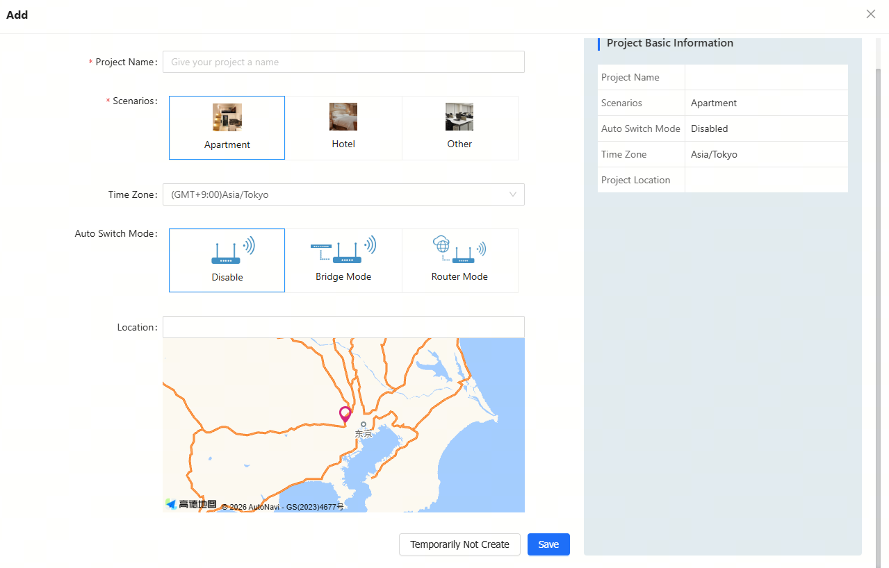

Step 3: Set basic project information.
Configuration Item Description:
  • Project Name: (Required) Specify a project name. A maximum of 256 characters are supported.
  • Scenario: (Required) Select a scenario. Defaults: Apartment scenario; Options: Apartment/Hotel/Others  (Note: For hotels and other scenarios, you can set the same SSID and password for all devices imported to the project. For apartment scenario, you can set a different SSID and password for each device imported to the project.)
  • Time Zone: (Required) Specify a time zone. Defaults: (GMT+9:00)Asia/Tokyo
  • Auto Switch Mode: (Required). Select a working mode. Disabled by default.
Disable: Disabling the automatic switching mode function.
Bridge: After selecting this option, the working modes of the devices imported into the project will be automatically switched to bridge mode after they go online for the first time.
Router: After selecting this option, the working modes of the device imported into the project will be automatically switched to routing mode when they go online for the first time.
  • Network Type:  Defaults: Cloud +AP (Manage  AP devices through the cloud.)
  • Bind Location: After binding the geographic location, the number of terminal devices added to the project will be marked and displayed on the Google map.

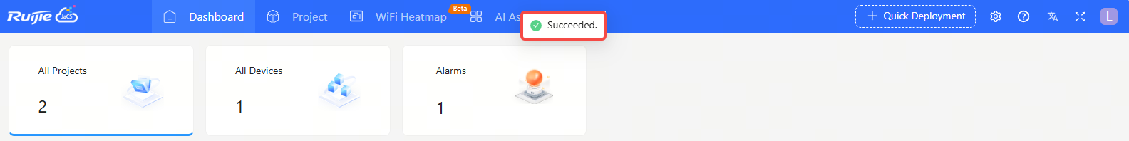

Step 3: After the message appears, the project is created successfully.
