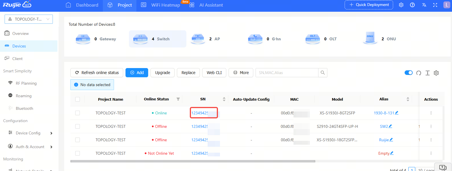

Click Project > Device > Switch to go to the switch management interface. The switch device list will display the information of all switches in the current project by default.
Item Description:
(1) Project Name: Displays the name of the project where the device is located.
(2) Online Status: Displays the online status of the device. The status of the device includes: Online/Offline/Not Online Yet. Click the filter icon  to filter devices by online status.
(3) SN: Displays the SN of the device. Click the SN number of a device to view its details.
(4) Configuration Status: Displays the configuration status of the device. Click the filter icon to filter the devices by configuration status.
(5) MAC: Displays MAC information of the device.
(6) Model: Displays device models.
(7) Auto-update config: Provides a switch to enable or disable the function of automatically delivering configurations to XS-S1620J series switches via Ruijie JaCS.
(8) Alias: Displays aliases of devices.
(9) MGMT IP: Displays the management addresses of devices.
(10) Egress IP: Displays egress IP addresses of devices.
(11) Firmware Version: Displays firmware versions of the devices.
(12) Last See On: Displays last online time of devices.
(13) Action: Delete button is available in the Action column. Click the delete button to remove the device from the project.
Button Description
   : Add button. Click this button to enter the device adding interface.
 : Upgrade button.
  : Configuration replacement button. You can synchronize the configuration of an old device to a new one of the same model. After configuration replacement task is created, the configuration of the old device will be sent to the new one when it is online.
 : Click this button to display more operation buttons, including:  Delete, and Restart.
  : Automatic refresh button. The automatic refresh button is enabled by default. When it is enabled, the switch device list will automatically refresh once every minute.
  : Manual refresh button. Click this button to manually refresh the switch list.
  : Click this button to customize the displayed items in the switch list.
 : Search box. Supports searching switches by SN, MAC, or alias.

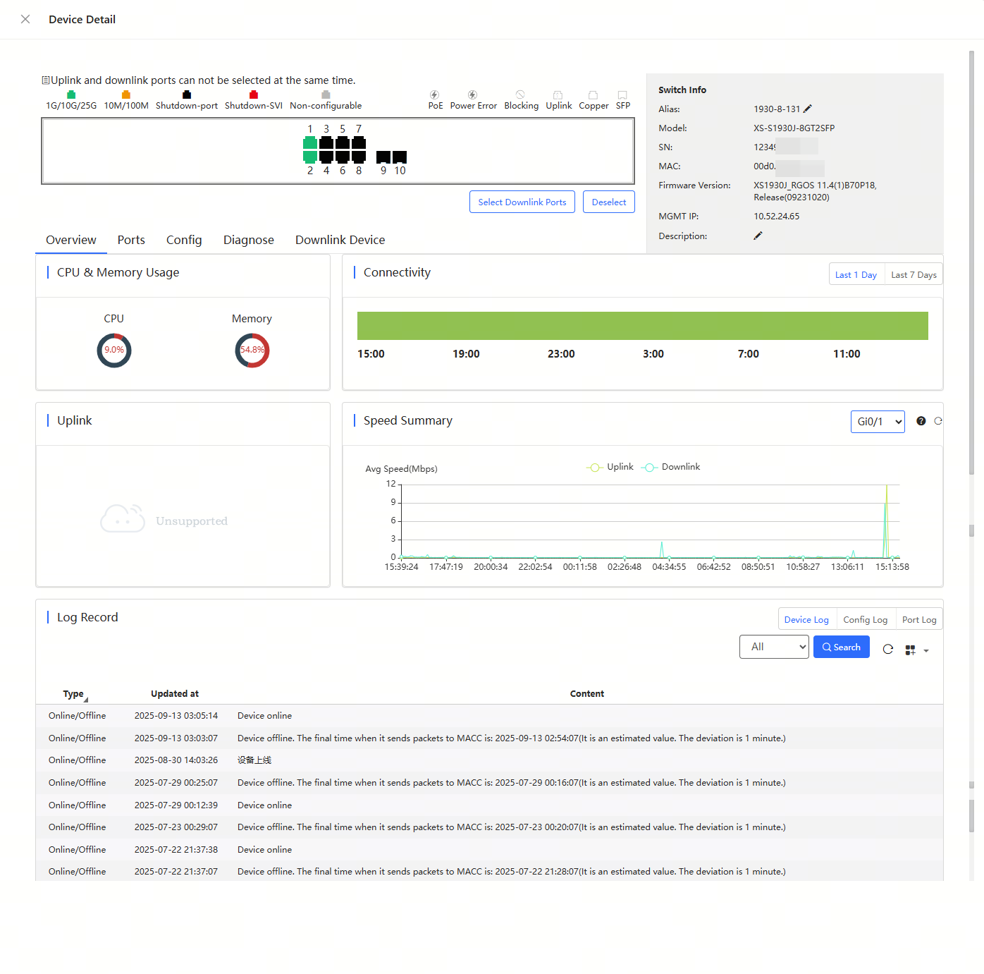

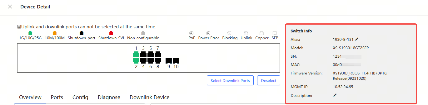

Click the SN of a switch in the switch list to check its detailed information. The detailed interface consists of port panel, basic information, device overview, device port, configuration, PoE, diagnosis and downstream devices.
(1) Monitor > Overview > Running Status

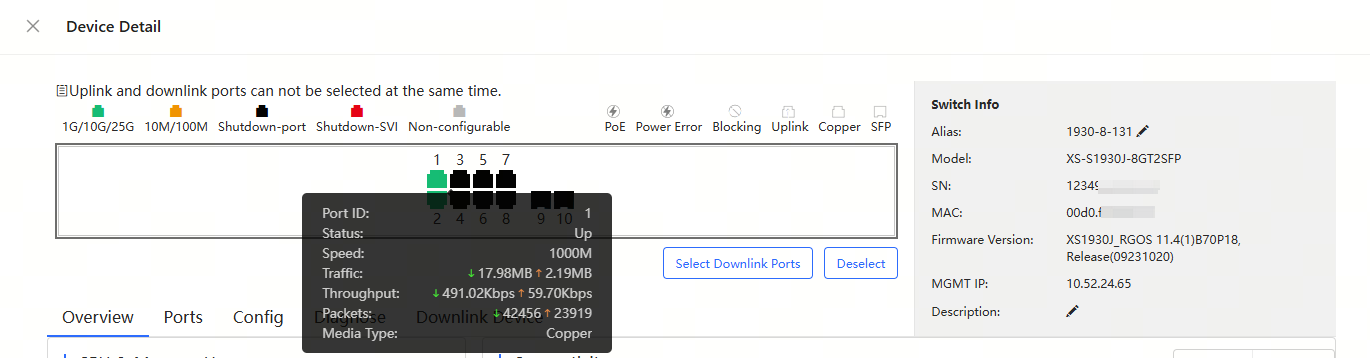

The port panel displays the port type, status and speed. When you hover the cursor over a port, you can view its port ID, traffic, rate, type and other information of the port.
The downlink device connected to the switch is displayed in the Associated Links part.  When you hover the cursor over a port, you can view its model, IP address and serial number of the device.
The connection trend displays the connection status of the device in the past 24 hours or seven days.
