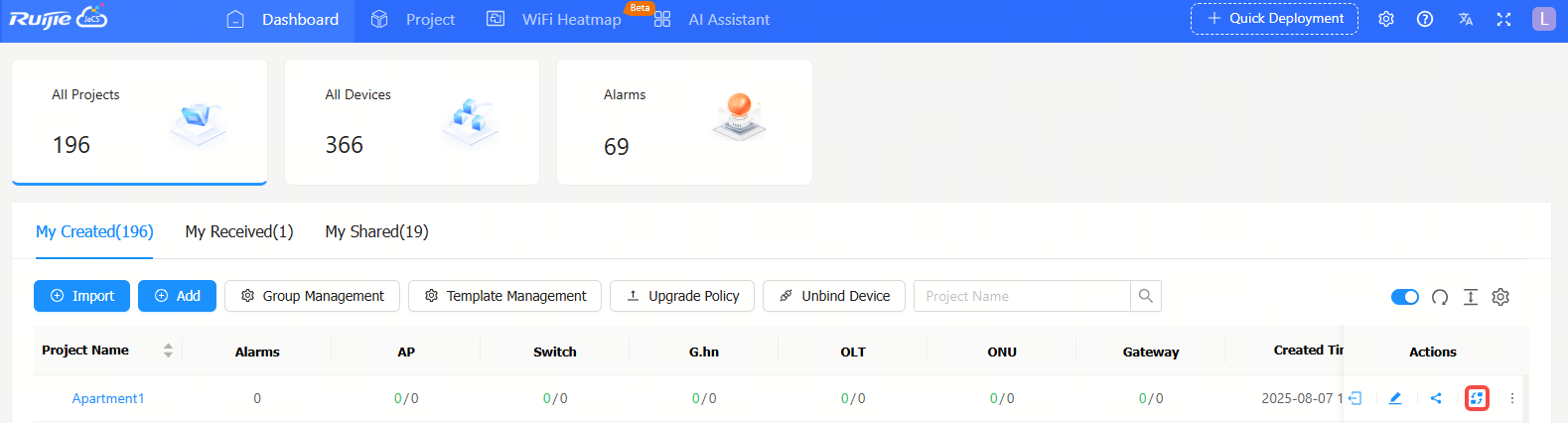

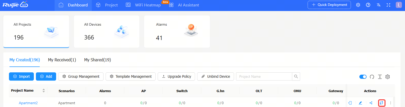

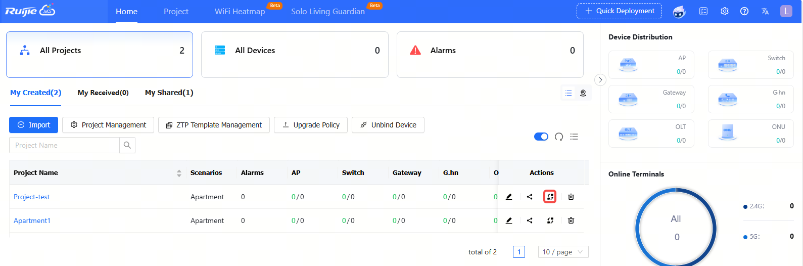

Step 1: Click the handover icon in the Action column of the project.

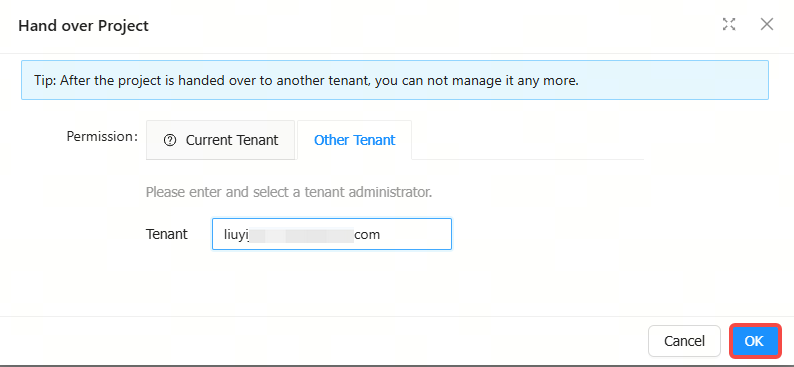

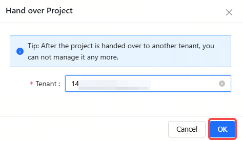

Step 2: Click Other Tenant, then enter the recipient's email address and click OK.

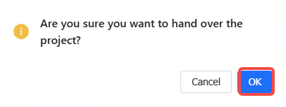

Step 3: When the “Are you sure you want to hand over the project?" message appears, click OK.

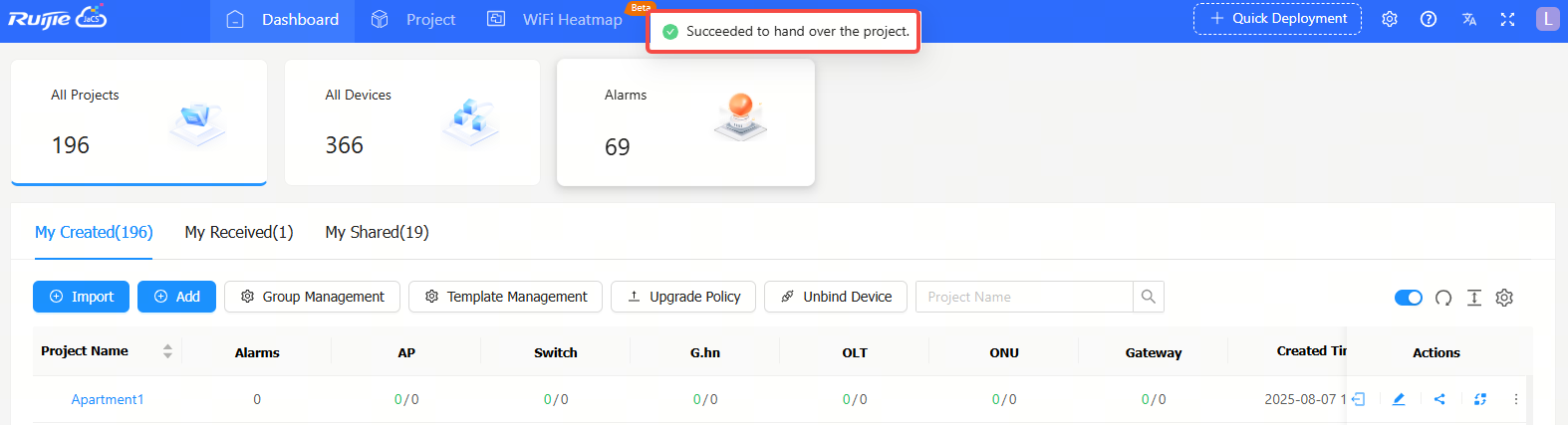

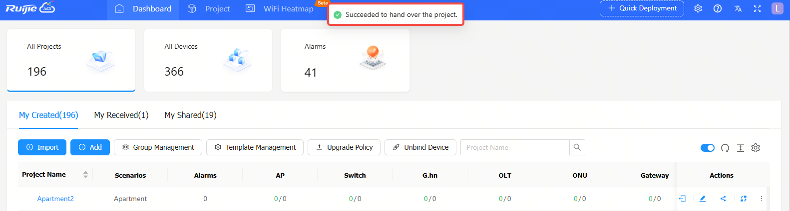

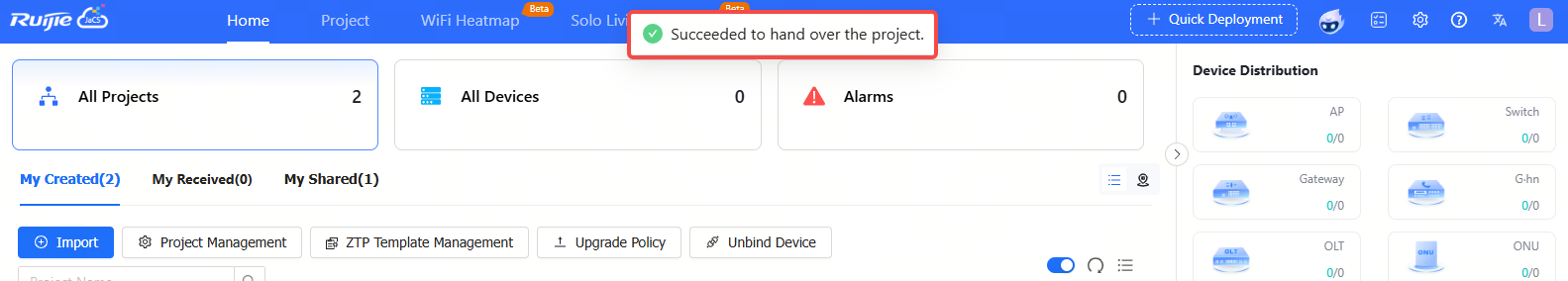

Step 4: After the "Succeeded to hand over the project" appears, the handover is initiated.
Note: While the recipient has not received the project, the original tenant can still manage the project. Once the project is received by the recipient tenant, the original tenant cannot manage the project any more.

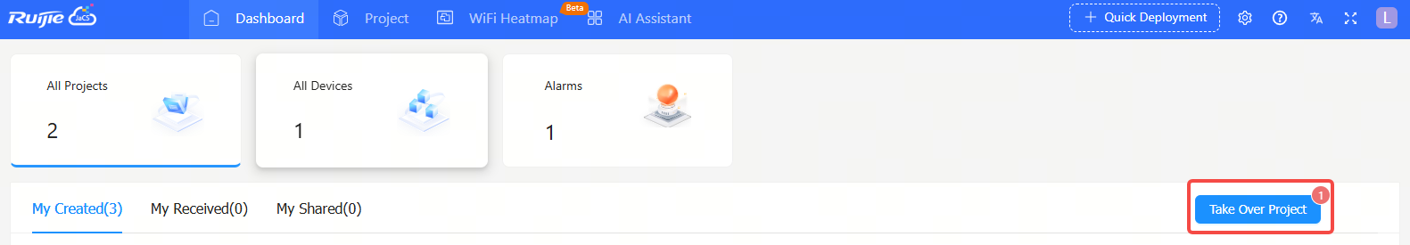

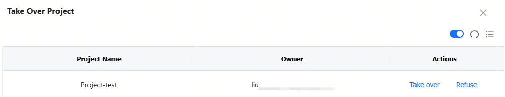

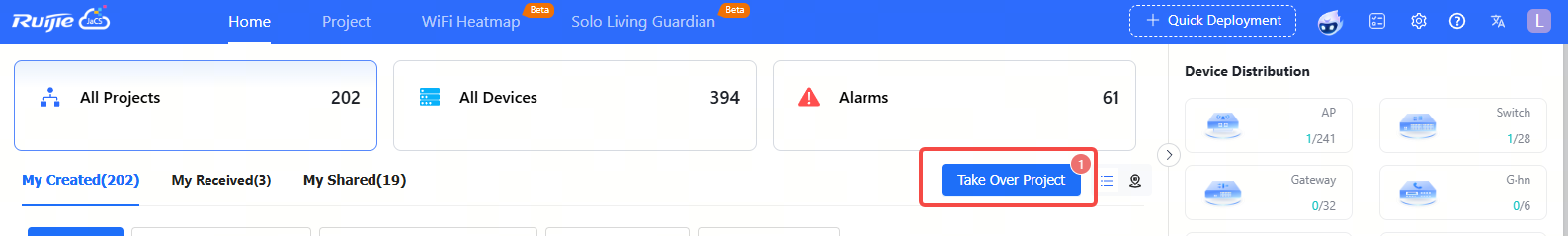

Step 5: After the project handover is initiated, the recipient needs to log in to the system and click the Take Over Project on the My Created interface to receive the project.
Note: The number in the red circle in the upper right corner of the Take Over Project button represents the number of projects currently waiting to be received.

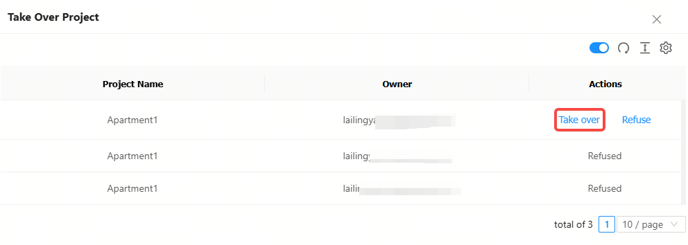

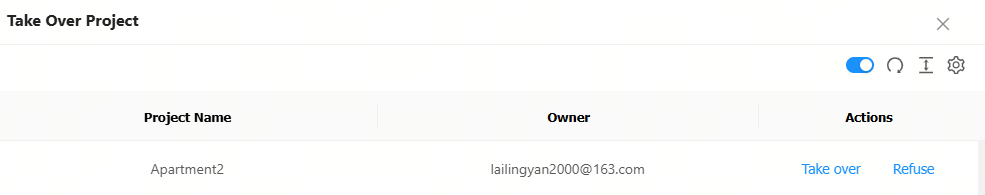

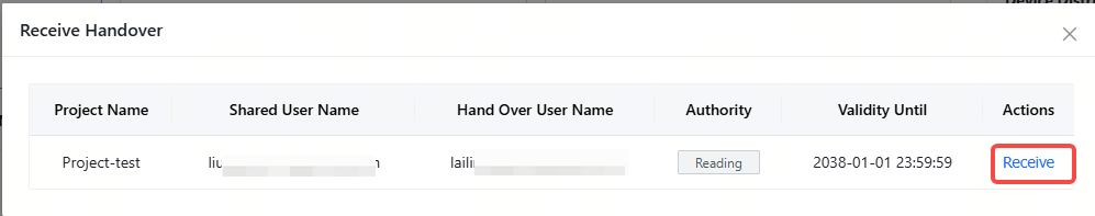

Step 6: Click Take Over to take over the project. If you do not want to take over the project, please click Refuse.
Step 7: When “Are you sure you want to take over the project” appears, click OK to complete the operation.

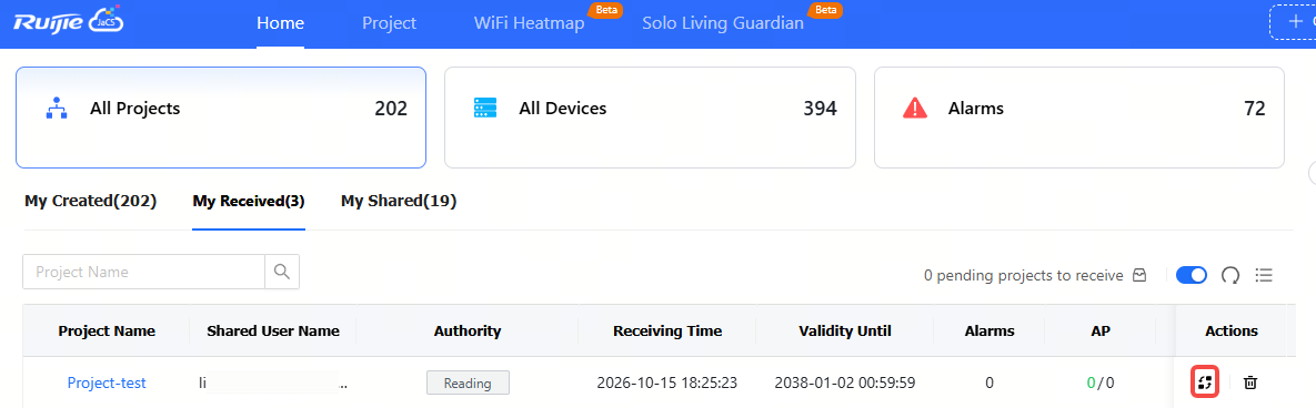

Step 1: Click the icon "".
Step 2: Enter the tenant's email address and click OK.

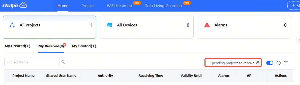

Step 3: The recipient logs in to JaCS and opens the My Received page. Click 1 pending project to receive.
Step 4: Click the Receive button to complete the project handover.
