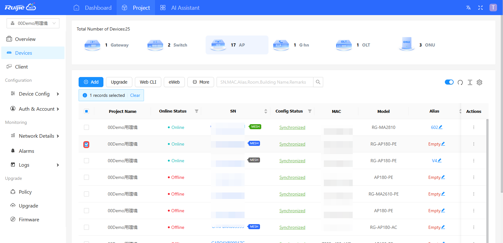

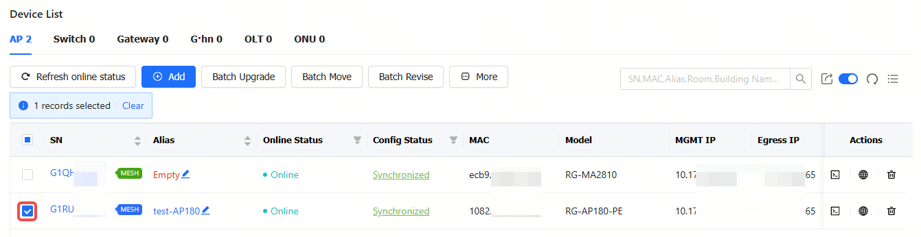

Follow the steps below to restore an AP to factory settings. This function is only supported on RG-AP180 series access points (except hardware version V4).

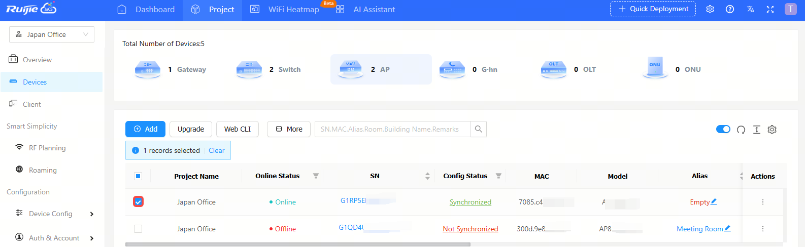

Step 1: Select the AP to be restored to factory settings.

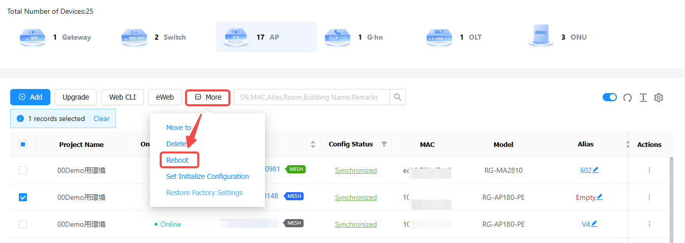

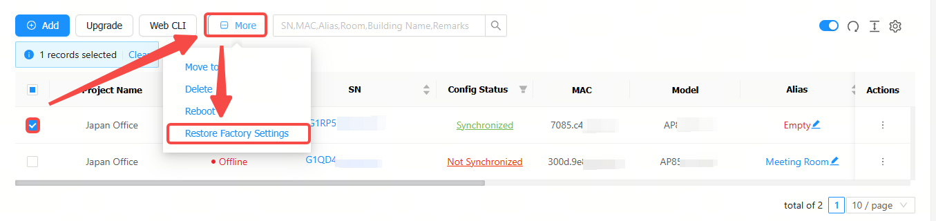

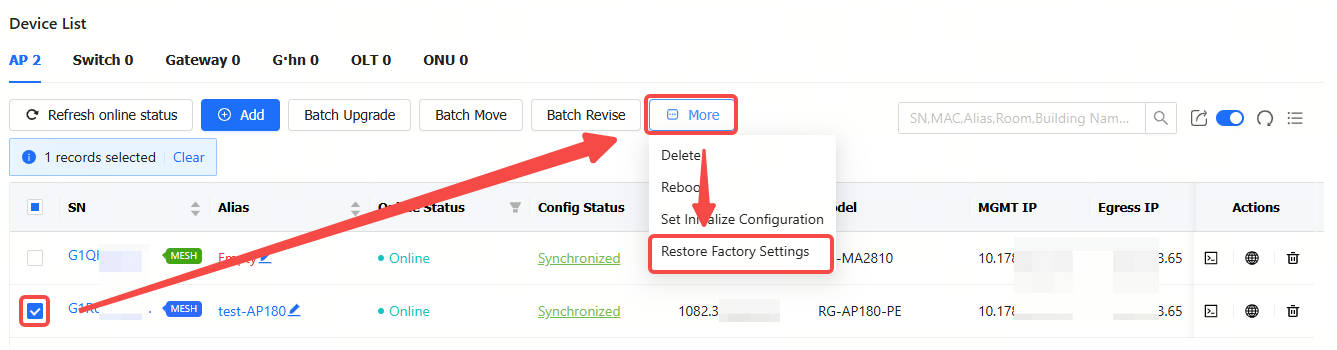

Step 2: Click More, and then click Restore Factory Settings.

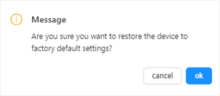

 Step 3: When the confirmation box appears, click OK to complete the operation.
