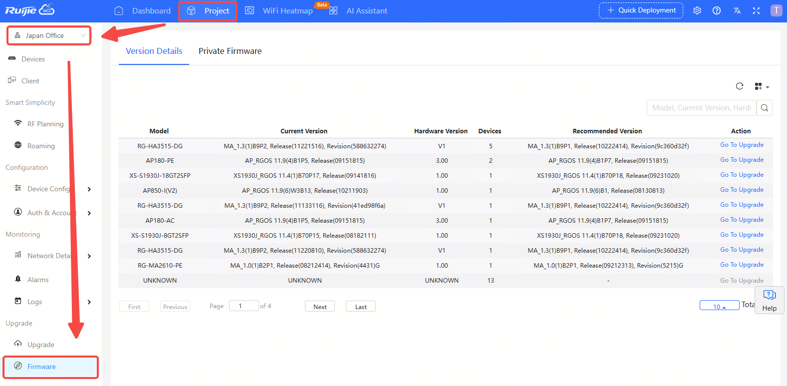

Click Project to go to the project interface. After selecting a project, click Firmware to manage the firmware in the specified project. The firmware management interface consists of two parts: Version Details and Private Firmware.
Version Details displays the firmware versions installed on all devices in the project. Click Go To Upgrade in the Action column to go to the upgrade interface. For detailed upgrade steps, please refer to Upgrading Device.
Private Firmware list displays the private firmware uploaded by all accounts under the tenant.
