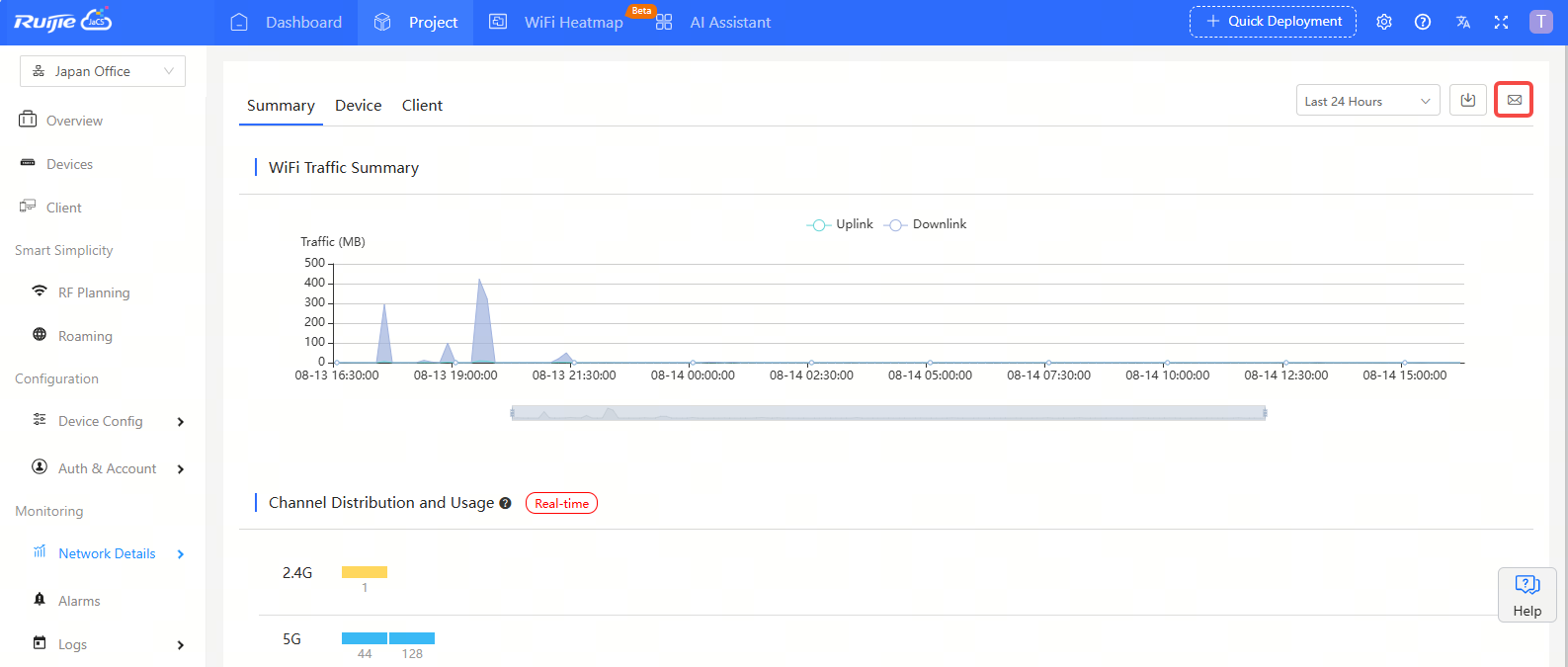

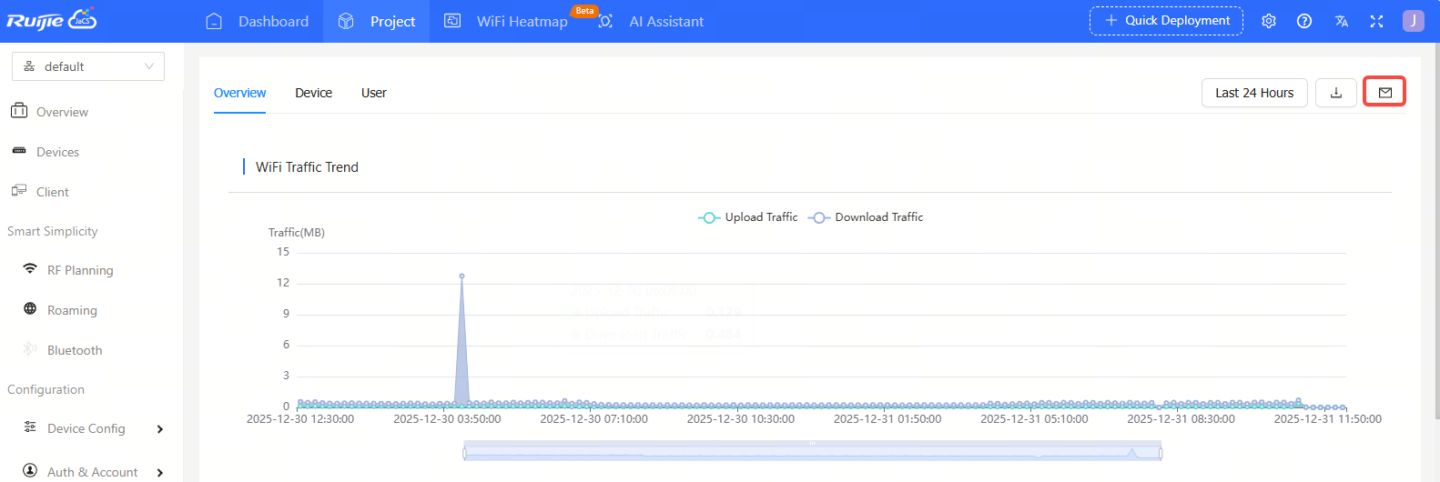

Step 1: Click .

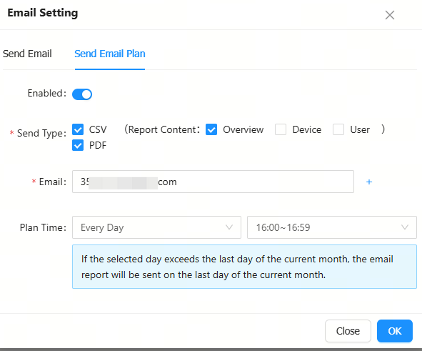

Step 2: Switch to the Delivery Plan interface. Enable the scheduled delivery function, select the report format, enter the email address, and set the scheduled delivery time, then click OK.
Notes:
1. Click the + next to the email address to add multiple email addresses. Up to 3 email addresses are supported.
2. If the report document format is set to CSV, you can select the report content. If it is set to PDF, the entire content will be sent by default.
