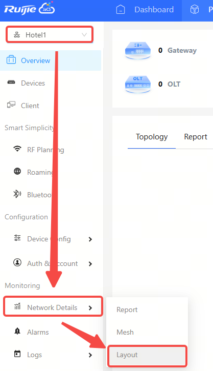

In the Layout interface, you can bind an AP in a specific project to a specific location. The specific steps are as follows:
Step 1: After selecting a non-apartment project, click Network Details > Layout to go to the configuration interface.
Step 2: Click Config Layout.
Step 3: Click Add Layout to add a layout.

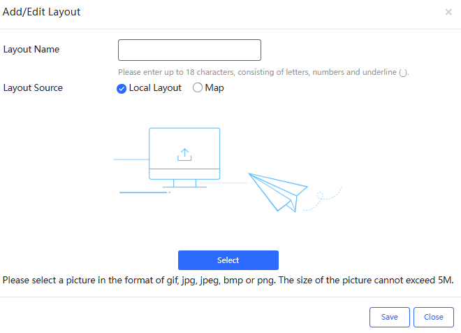

Step 4: After setting the layout name, layout type, select a image or bind a location and click Save. (Here takes add a local layout type as an example)
(1) Layout Name: Required. Set the layout name. You can enter up to 18 characters. The following character types are supported: letters, numbers, and underscores (_).
(2) Layout Source: Defaults: Local Layout.
  • Local Layout: Local layout can be used to bind the location of indoor APs.
  • Map: Map layout can be used to bind the location of outdoor APs.
(3) Select: Click Select to upload a picture if you set the loayout source to local layout. You can upload a picture in the format of GIF, JPG, JEPG, BMP or PNG. The size of a single picture cannot exceed 5M.
(4) Bind Location: If you set the layout source to Map, you need to specify the location to be bound.
Step 5: When the "Operation succeeded " appears, the setting is completed. Then, you can pull down the layout selection box to select the newly created layout.
