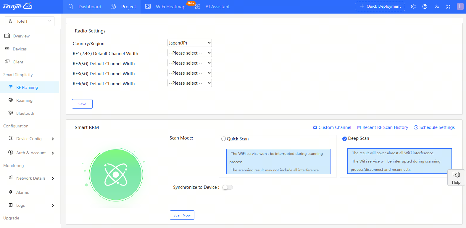

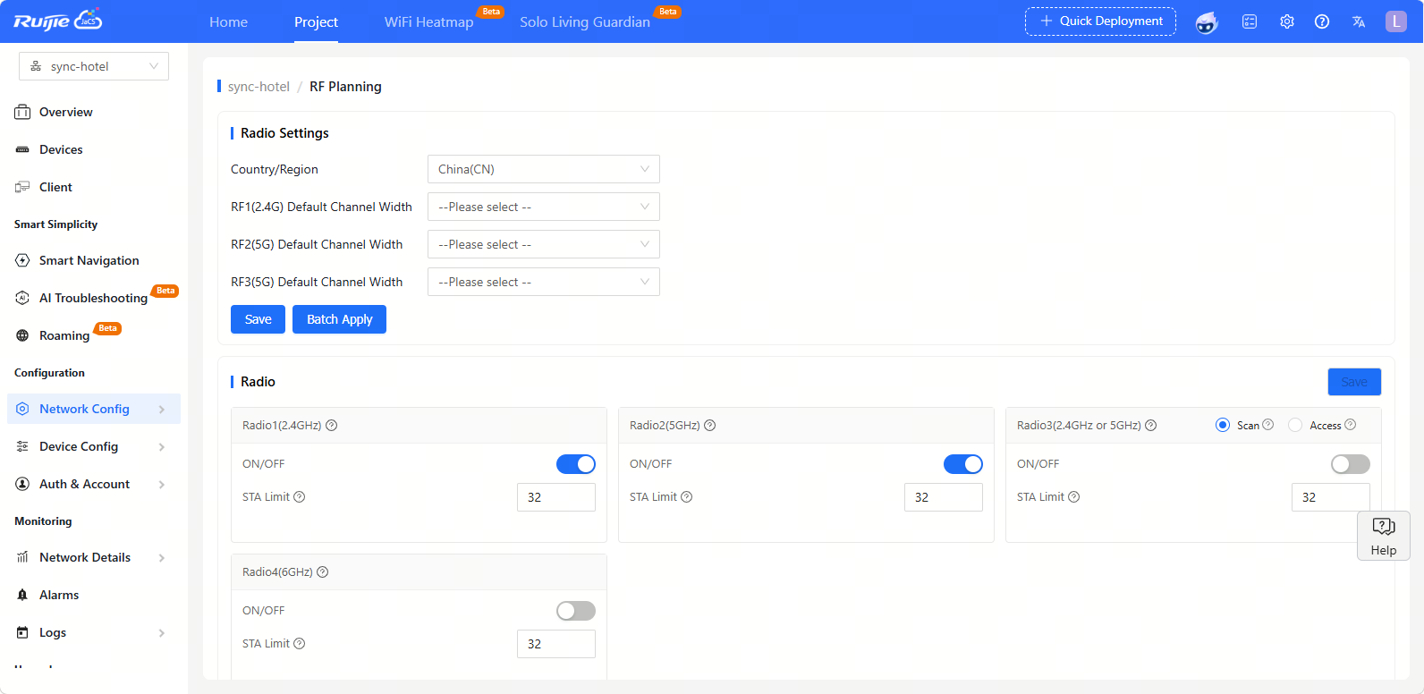

Radio planning can adjust the channels and power of APs in the same area network, thereby optimizing the channel allocation and power of APs. Reasonable radio configuration planning can reduce channel interference, improve channel utilization, and enhance the overall performance and capacity of the wireless network. Click Project > Network Config > RF Planning to enter the radio planning settings interface, which consists of three parts: Radio Settings, Smart RRM, and Manual Planning.
Radio Settings
(1) Country/Region: Defaults: Japan(JP)
(2) RF1(2.4G) Default Channel Width: Defaults: N/A; Options: 20 MHz/40 MHz
(3) RF2(5G) Default Channel Width: Defaults: N/A; Options: 20 MHZ/40 MHz/80 MHZ/160 MHZ
(4) RF3(5G) Default Channel Width: Defaults: N/A; Options: 20 MHZ/40 MHz/80 MHZ/160 MHZ
(5) RF4(6G) Default Channel Width: Defaults: N/A; Options: 20 MHZ/40 MHz/80 MHZ/160 MHZ
   Note: For Ruijie devices, RF3 is used to support the 5G 11ax (Wi-Fi 6) standard, which means it can deliver higher bandwidth and better performance.

On Smart RRM page, the APs of the project can be triggered to scan the RF, display recommended RF configurations calculated after scanning, and save the recommended RF configurations to APs.
(1) Scan Mode: Deep Scan is selected by default.
     Options:
  • Quick Scan: This mode enables APs to provide the Wi-Fi service properly during scanning. However, data acquired in this mode is not as accurate as that in the Deep Scan mode. This mode is applied when it is expected that the current network is not affected.
  • Deep Scan: This mode is also referred to as the enhanced mode, and causes wireless clients to go offline at the beginning and ending of the scanning. Data acquired in this mode is more accurate than that in the  Quick Scan mode, and the automatic RF planning based on the data is more accurate. This mode shall be applied if you can accept that the clients go offline during the scanning.
(2) Synchronize to device: Disabled by default. When it is enabled, the RF scan results will be automatically pushed to the AP.

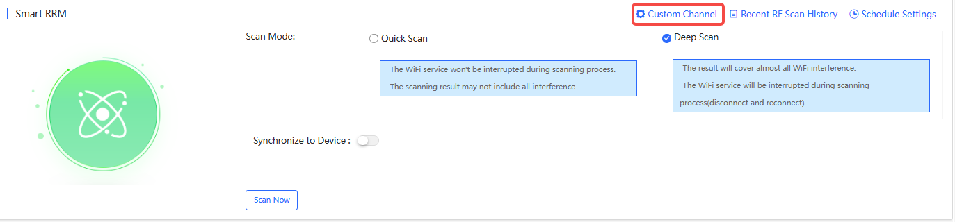

Click Custom Channel to enter the configuration interface. This function is disabled by default. When enabled, you can customize the 2.4 GHz and 5 GHz channels. After setting the channel according to the actual situation, click Save to complete the configuration.

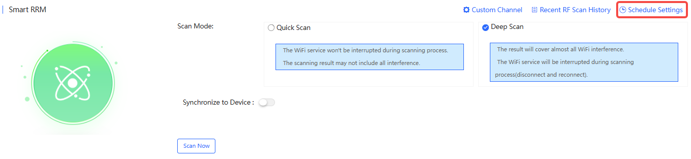

Click Schedule Settings to start the RF automatic scan at a scheduled time. The scheduled scan function is disabled by default. After enabling it, you need to select the scan mode, set the time, and choose whether to synchronize the results to the device. And then click Save to complete the operation.
