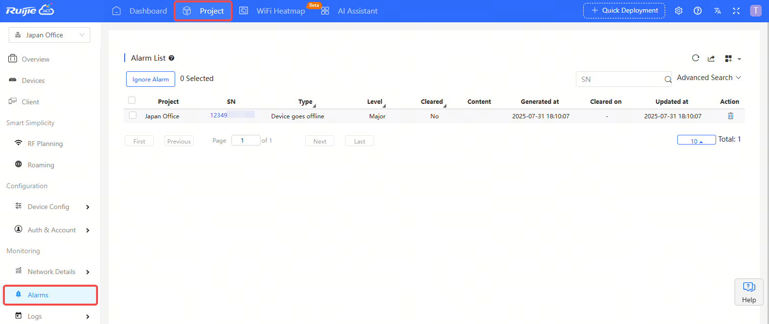

In the project management interface, click Alarms to enter the alarm management interface. In this interface, you can view the alarm information in the current project. An alarm can be searched based on the AP’s serial number, alarm type, alarm level, and alarm occurrence time.

The Alarm List shows the all alarms of the current project. To ignore generated alarms:
Step 1: Select the alarm to be ignored, and then click Ignore Alarm.
Step 2: When the operation confirmation box appears, click OK.
Step 3: After successfully ignoring the alarm, click X to close the prompt box and complete the operation.
To clear the alarm in the list:
Step 1: Click the  in the Action column of the alarm to be cleared.
Step 2: When the confirmation box appears, click OK.
Step 3: After successfully clearing the alarm, click X to close the prompt box and complete the operation.
