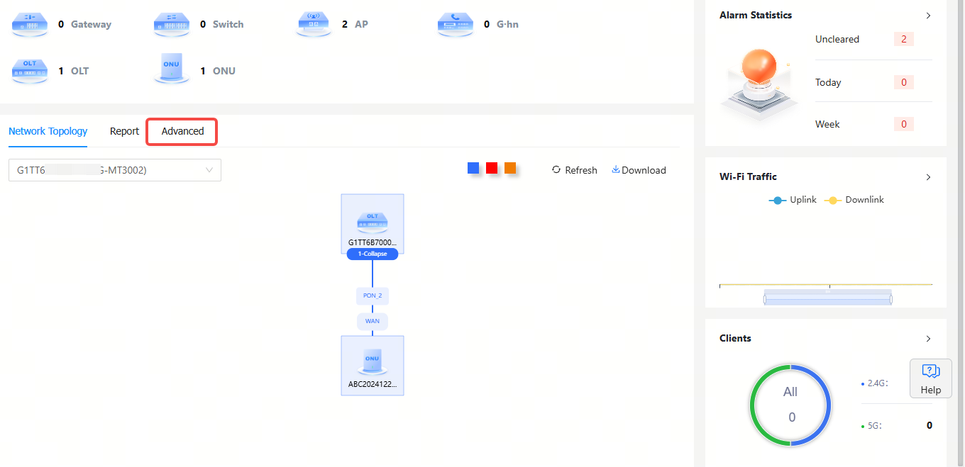

To view a topology of an online device:

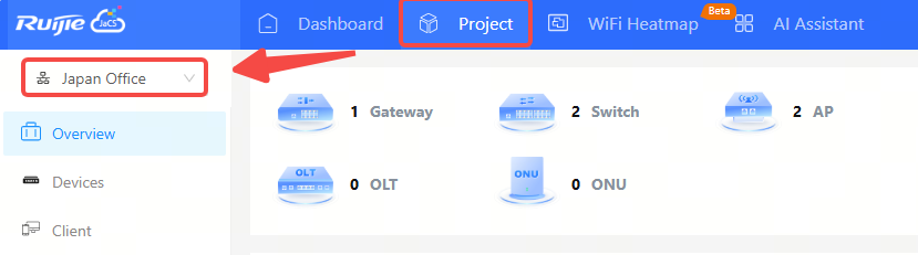

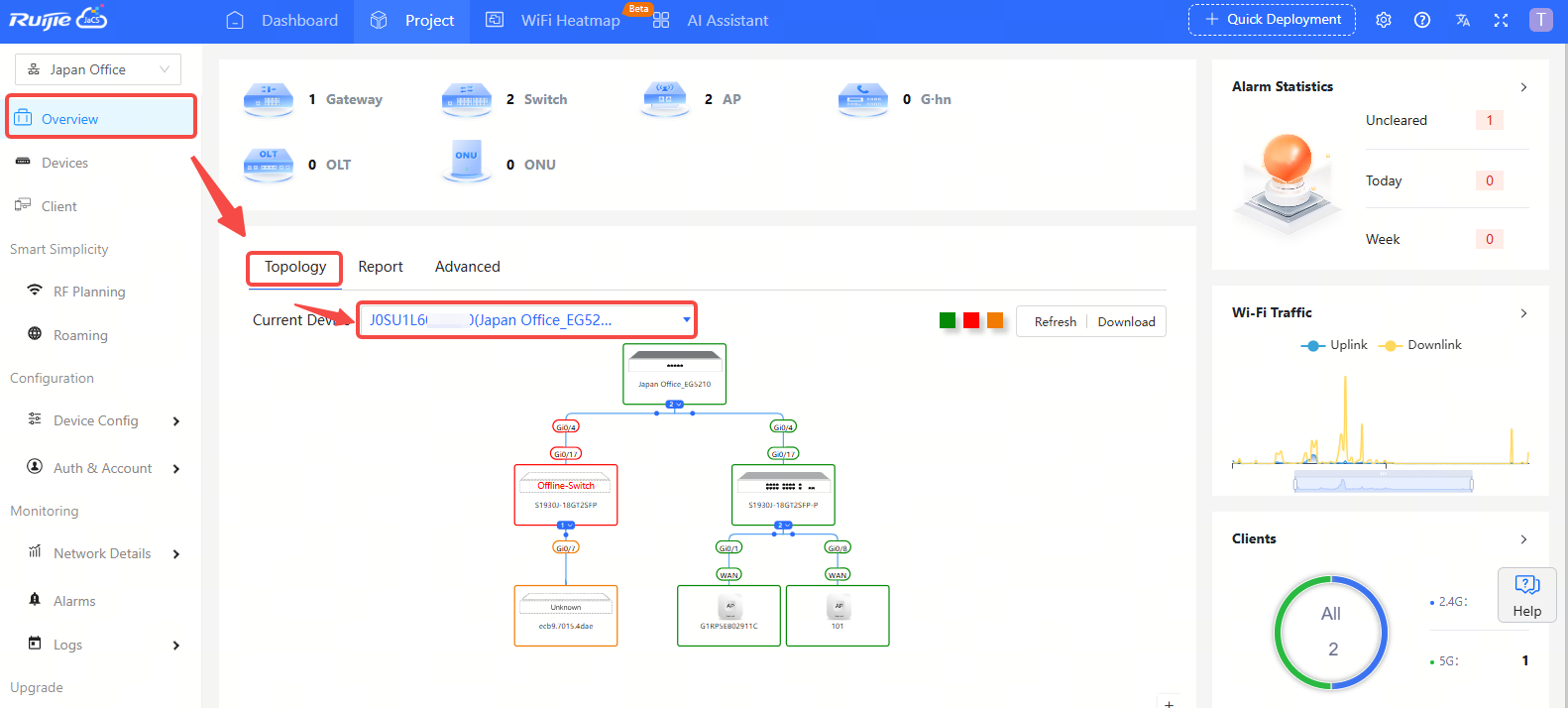

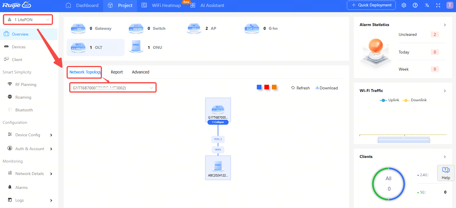

Step 1: Click Project, and the select the project where the device is located.

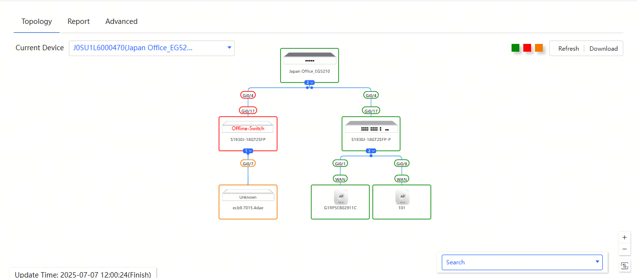

Step 2: Navigate to Overview > Topology to go to the topology interface. Select the device you want to view. After selecting, the topology of the device will be displayed below.
Different colors in the topology represent different link states.
(1) Green means the device is functioning normally.
(2) Red indicates the device is offline or disconnected from the switch.
(3) Orange means the device is not connected to the cloud or belongs to another account.

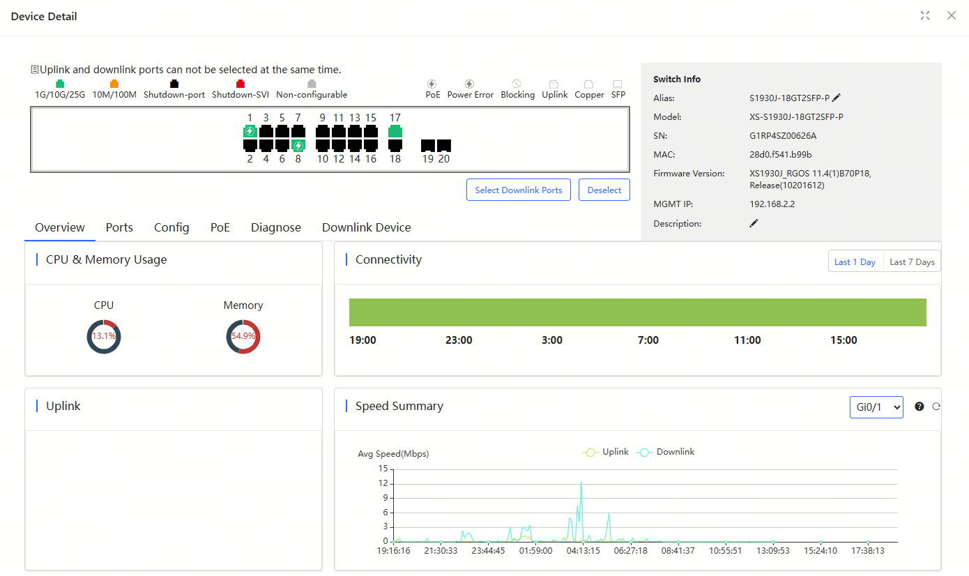

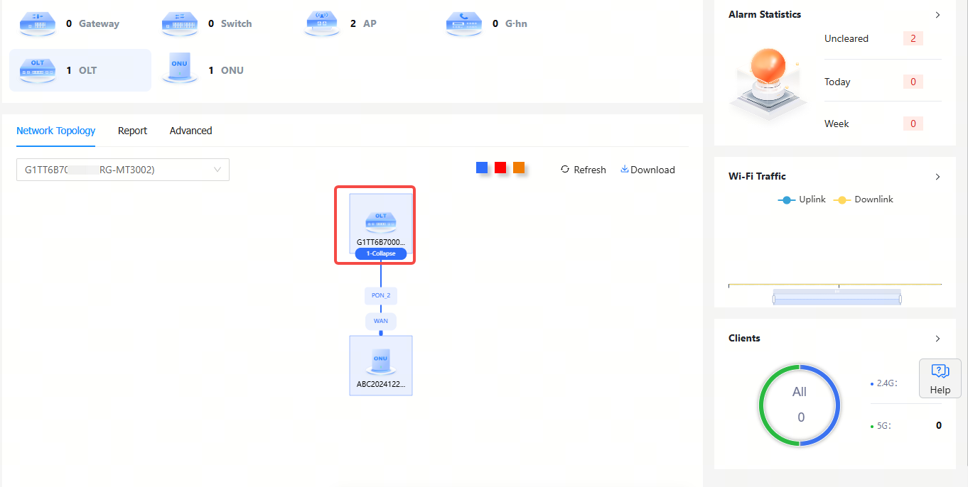

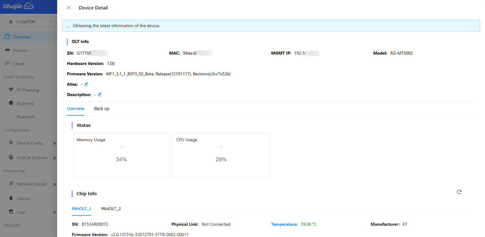

Click a device image, you can view its detailed information.
Refreshing Topology

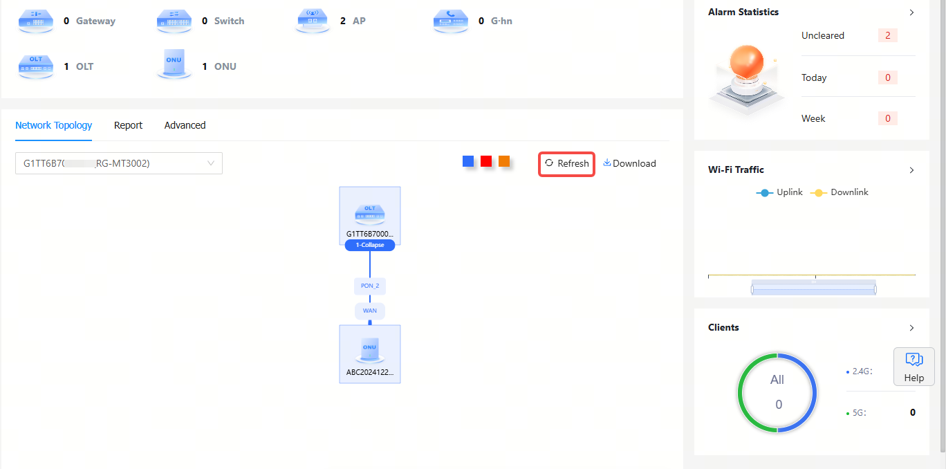

Click Refresh to refresh the downlink topology of the device. The refresh interval should be greater than 10 minutes, otherwise a prompt will appear indicating frequent operations. The topology update is triggered when the switch is selected for the first time.
To refresh the topology regularly:
Step 1: Click Advance to go to the setting page.
Step 2: Enable the schedule refresh function.
Step 3: Set the refresh interval and effective time period, and then click Save.
Note:  The minimum interval time supported is 2 hours, and the maximum interval time supported is 23 hours.
Step 4: After the "Operation succeeded" prompt appears, click X to close the prompt box and complete the operation.

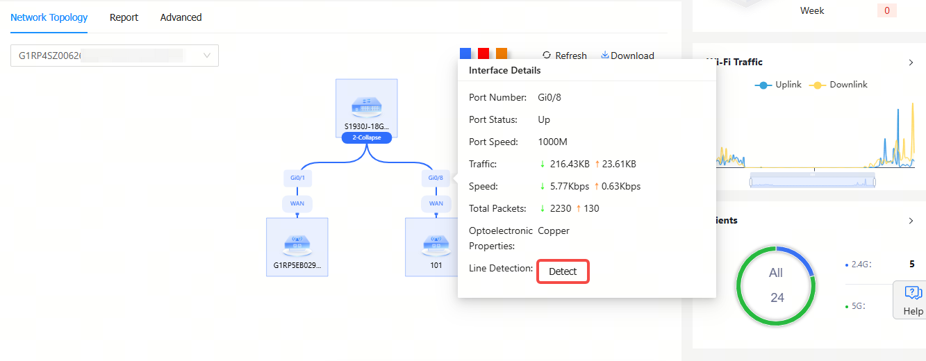

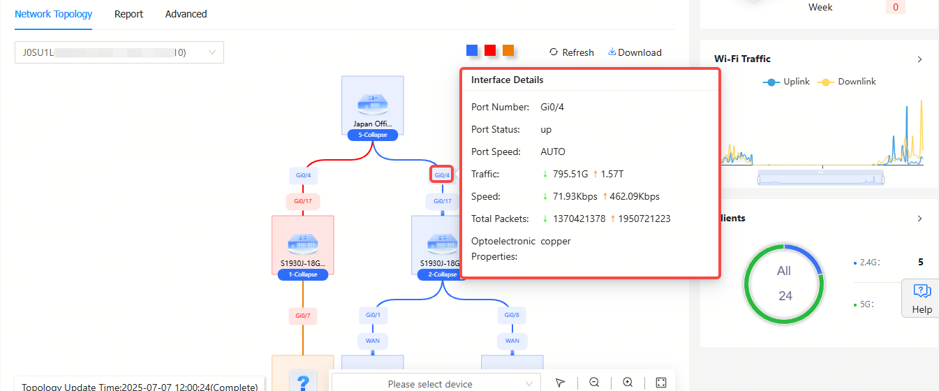

Click a port icon in the topology, you can view its detailed information. The port information includes: port ID, port status, speed, upstream and downstream traffic, throughput, upstream and downstream packet rates, and port types.

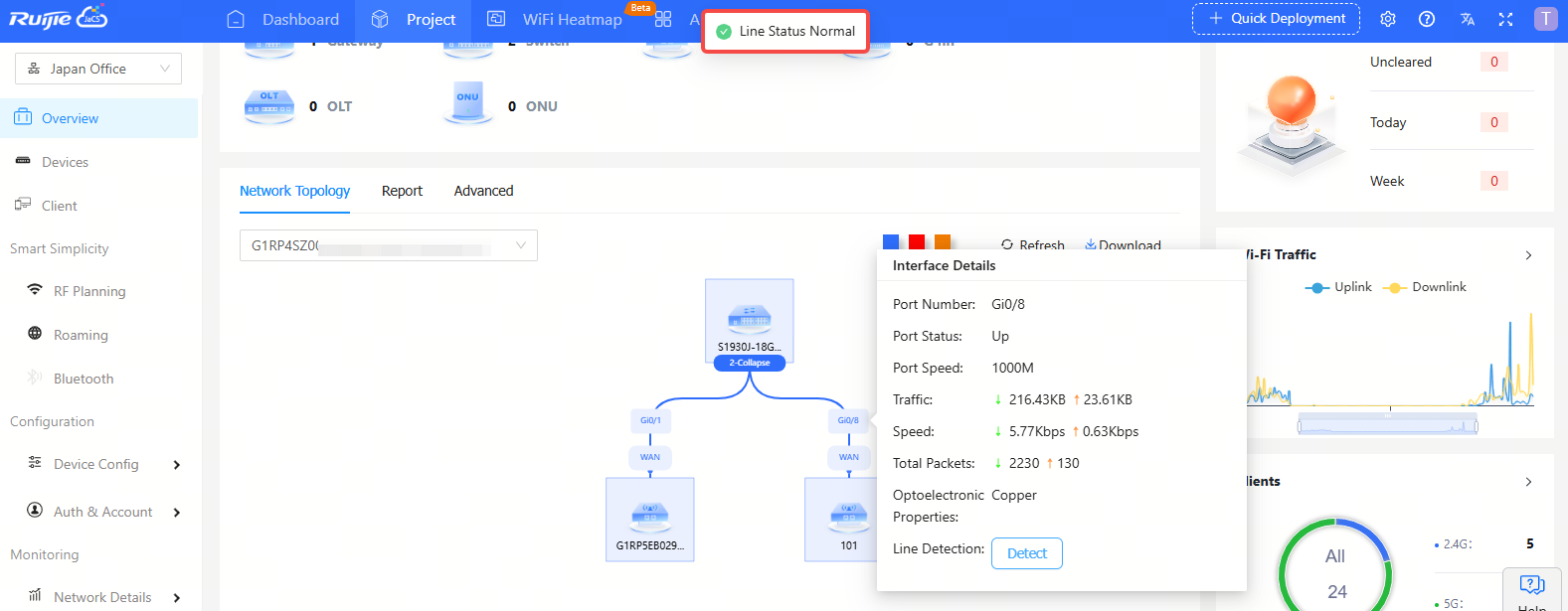

In the topology, hover the cursor over a port to view its detailed information. In the detailed information box, click Detect to initiate link detection. Do not perform any operations during the detection process. The possible outcomes are: link normal, link fault, or no link.
Note: The physical link detection function is not available for RG-EG5210-JP.

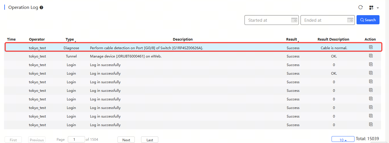

After the detection is completed, you can view the operation log in Operation Log interface.

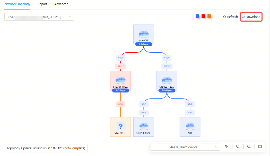

Click Download to export the current topology diagram.
